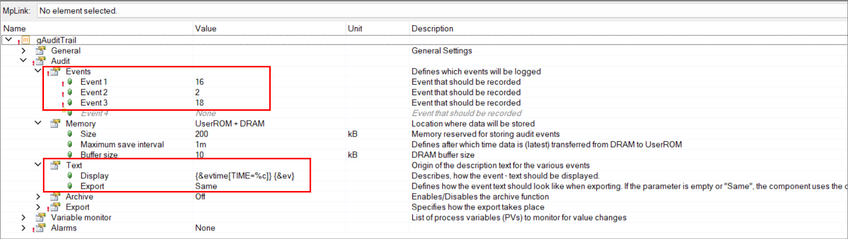

There seems to be other things that might have to be adjusted as well.
This is how my configuration looked like in AS 4.12:
Now, after I’ve converted my project to AS 6 the same configuration looks like this:
I believe that these changes are the reason that I can’t see any audit events in the HMI.

By changing the event ID, the events was visible in my HMI. However I still haven’t managed to get the correct texts in the event since I don’t really understand how to configure the Text/Display property.
I did observe that the constants of the event types have changed. For instance, let’s look at the audit custom event:
In AS 4: Event ID = 18
In AS 6: Event ID = 402

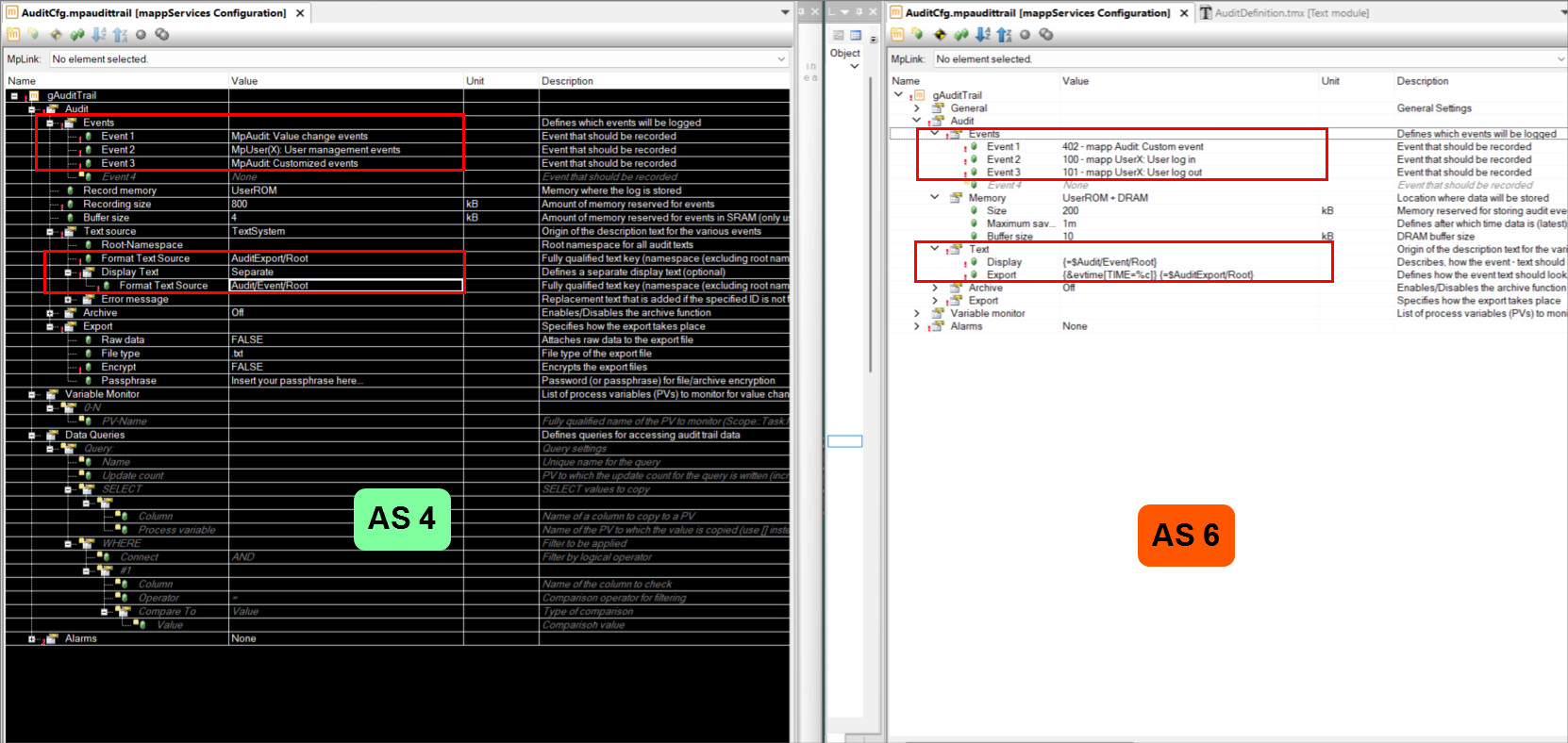

I’ve now learned that in AS 6, you need to add ‘=$’ at the beginning of the text ID and bracers { } around the text ID.
In my project, I’m using a .tmx file for the audit texts of my custom events. The text ID (namespace) is Audit/Event
Configuring the text source:
AS 4: Audit/Event/Root
AS 6: {=$Audit/Event/Root}
When converting a project from AS 4 to AS 6, the text source will be set to default value: {&evtime[TIME=%c]} {&ev}
So you need to change this manually.
The Text source property in the MpAudit configuration is now called Text/Display.
The picture below shows what I had to change in order to get the audit event texts to show properly in the HMI:
