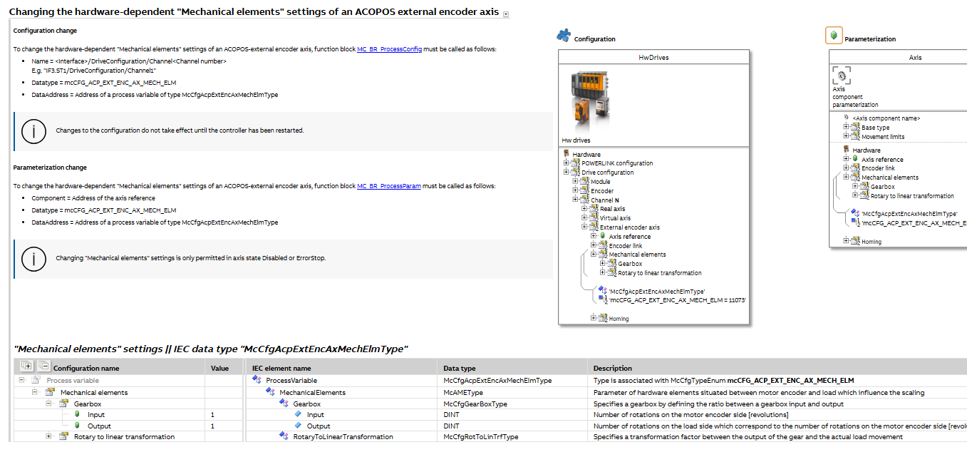

There is a headline Changing the hardware-dependent "Mechanical elements" settings of an ACOPOS external encoder axis which seems to be exactly what you need:

Here we had a nice Picture about the two Functionblocks and some notes.
One Functionblock uses Write the other Save | Read vs. Load.
Picture for Overview

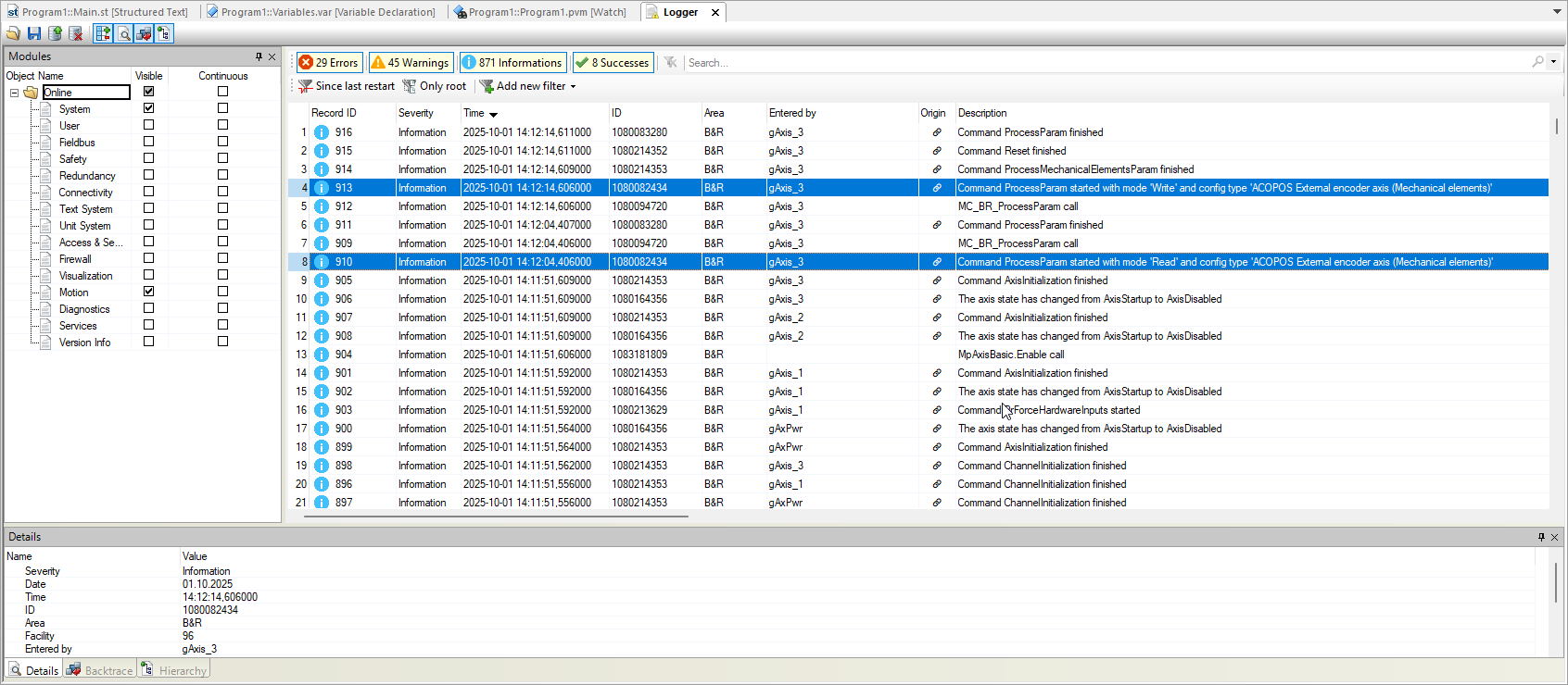

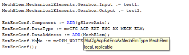

Hi Michael,

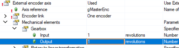

It seems writing to this specific datatype is not permitted:
afbeelding
for testing:
Test1 := 7
test2 := 3

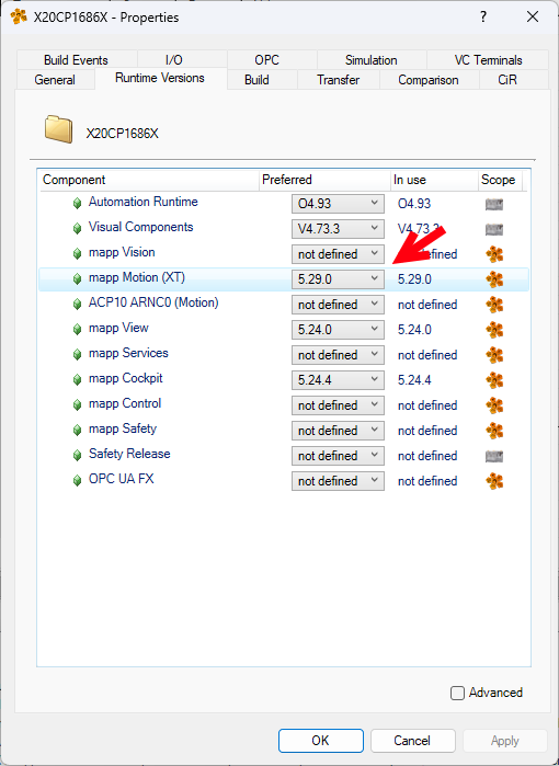

Can you please have a look at the used MappMotion Version. The Documentations states that a minimal Version 5.16 is reqired for this function. I have tested in the newest Version 5.29.
For me it looks good. I made first a Read then a Write.
You may have to think about the ReferenceDistance, but if i let this 0.0 i got an different Error.

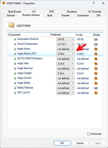

I am using AS6.3.3.14, MappMotion version is 6.4.1. When I click “Advanced” the component McAcpPar (which looked like it had something to do with parametrization writing) was disabled, I put it on 6.4.1 but this does not make the difference so far.

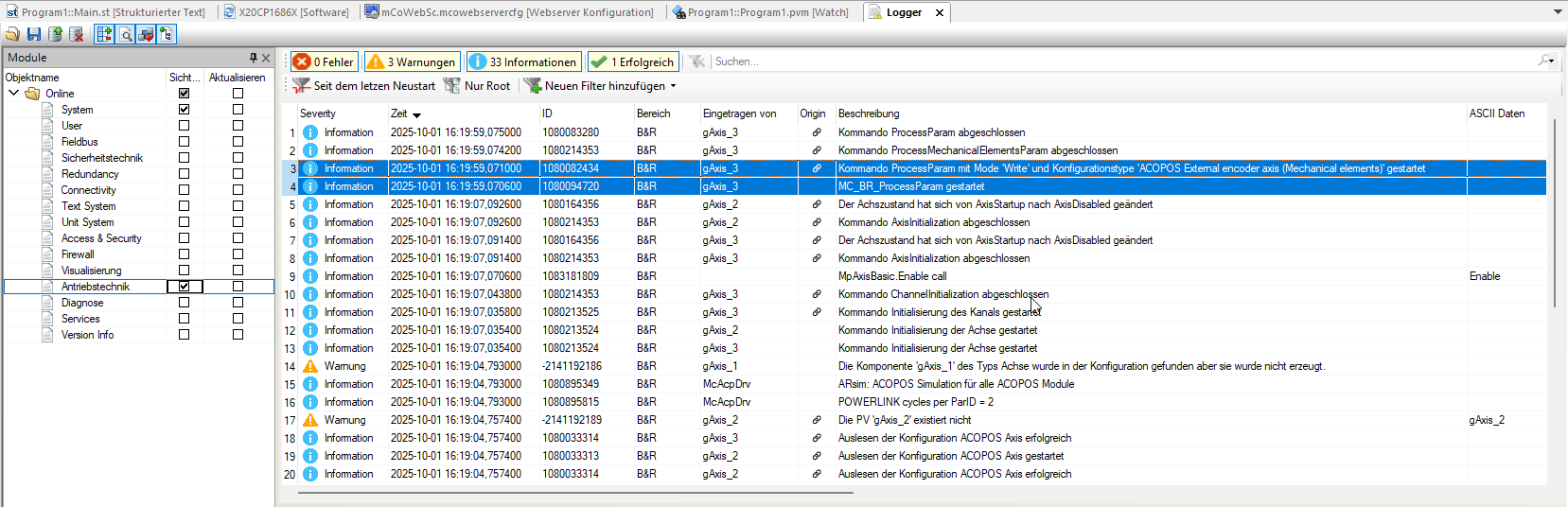

With mappCockpit and DriveLog it is possible to see which parameters are written to the drive (ProcessParam).
The library McAcpPar only contains constant definitions for the different Acopos parameters.
The only way i know how to have some feedback of whats happening with the active Parameters is the display in the MappCockpit.

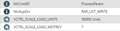

In the DriveLog on MappCockpit I could only find SCALE_ENCOD2_REV which showed me the output gear of my external encoder.
I also want to change my own axis’s gear ratio with MC_BR_ProcessParam, I have executed the block and it gives a done signal, is there some way to also read the input/output gear somewhere, to make sure the block was succesful, not only relying on the done signal.
the gear ratio of the axis ends up on these ParIDs:
VCTRL_SCALE_LOAD_MOTREV = Mechanical elements/Gearbox/Input
VCTRL_SCALE_LOAD_UNITS = Mechanical elements/Gearbox/Output x Mechanical elements/Rotary to linear transformation/Reference distance x 1/Measurement resolution
