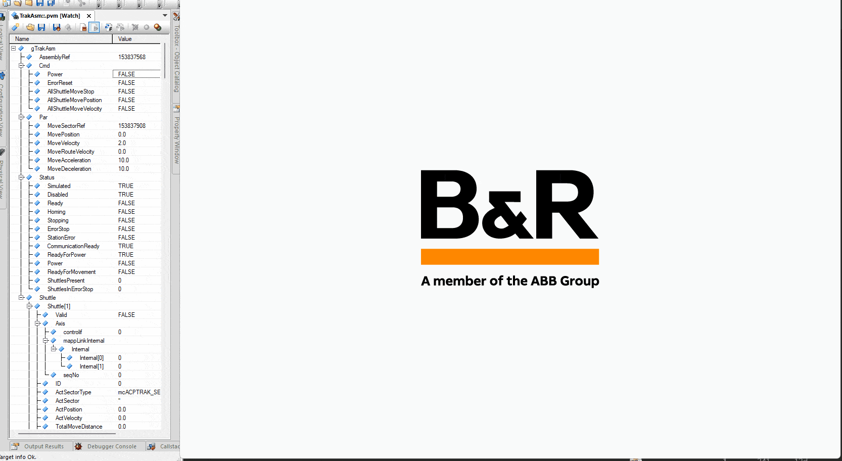

Here a little gif as a teaser :shushing_face:
AcoposTrakViewer1
I hope this will generate some interest!
I’m open to feedback! I didn’t share it at the moment because it’s still as PoC.
