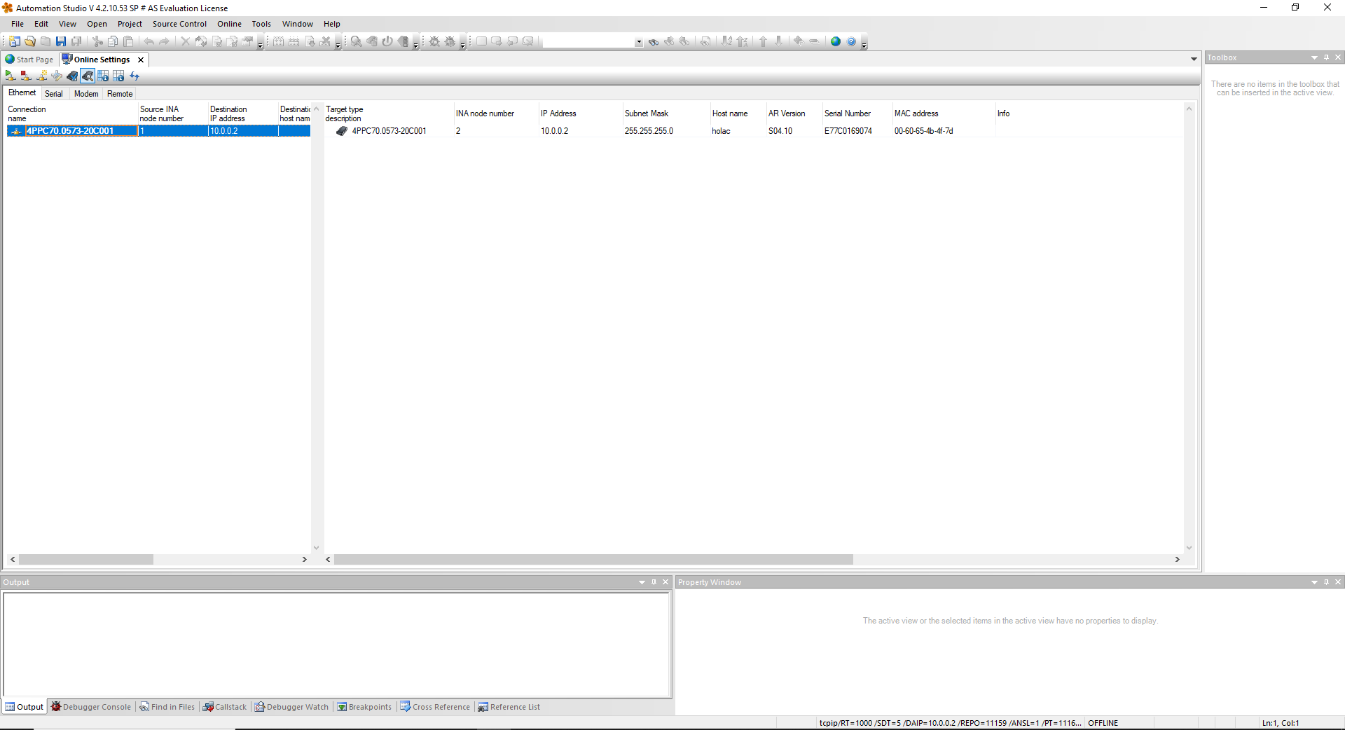

I’m quite new to B&R PLC systems, but after reading various forums, I tried to connect to the PLC using Automation Studio 6 and 4.2 to check the logs via the Logger and find out why the machine can’t fully boot. Currently, the machine starts loading, briefly reaches the main menu for a second, then reboots again and ends up stuck in BOOT mode: Service.
I managed to connect to the module over Ethernet, changed the Subnet Mask in Windows Ethernet settings and the module was detected. I then connected to it and tried to use “Open Project from Target”, but I received the following error:

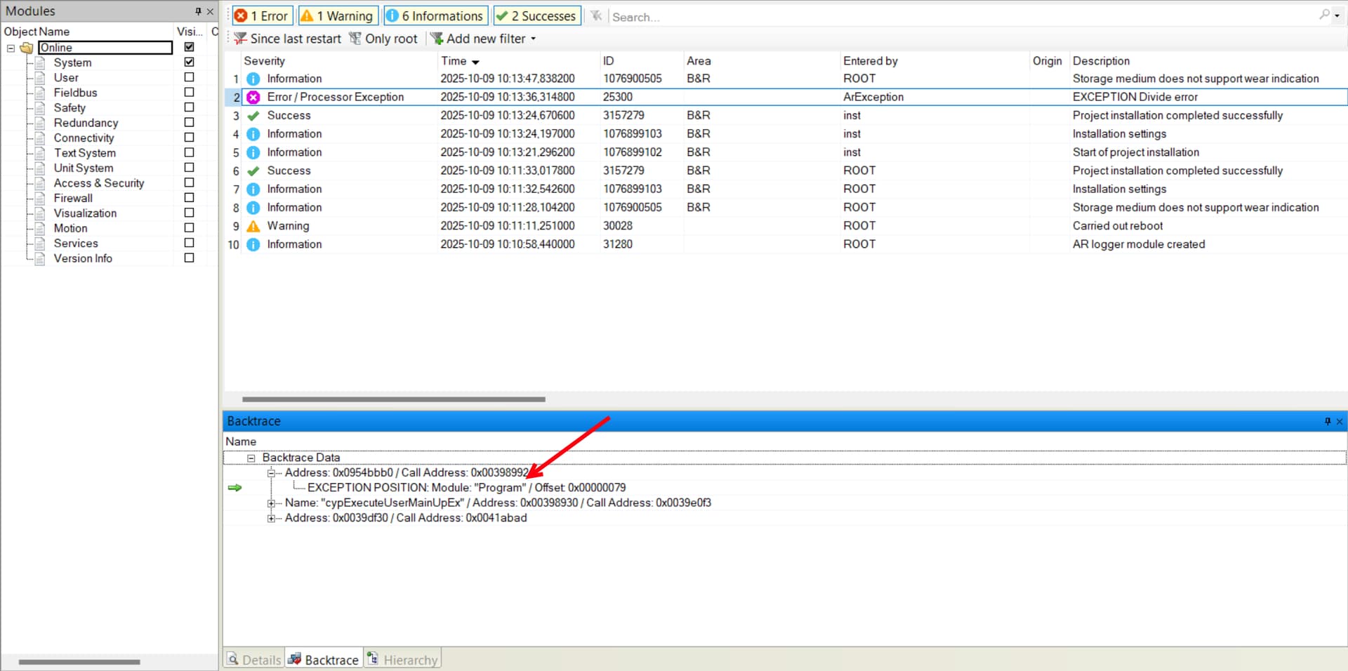

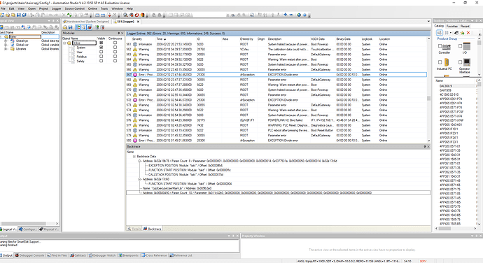

In most cases, you will not find the project on the PLC. When you are connected to PLC with Automation Studio, try to read PLC logger. Make sure to check all boxes and see if there are any errors or warnings.

I understand that before going in to Logger I need open the project? Cause Logger function like almost others functions are unavailable.
Now Im connect via Enthernet to the PLC. What’s the next step?
Also I just tried connect to the SDM via browser and it was succesfull. There the image.
You can just create a project with the PLC and then go online. Just make sure that you don’t download the project. In the previous post you are not connected to the PLC. The bottom right still says offline. Try right click on the connection and then choose “connect”. But the SDM is good enough, too.

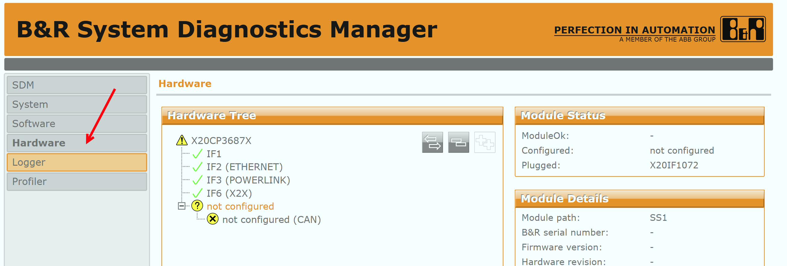

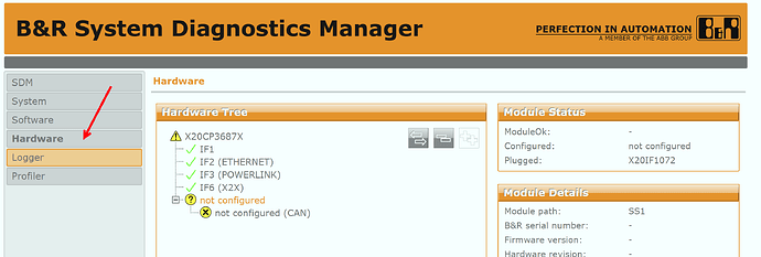

You can see that the PLC goes into error state because you have a divide error. Most cases this is division with 0. The PLC logger might give you more details. I guess you did not change the software so something else must have changed. Do you know if the PLC uses config files that might be missing? Can you go to Hardware in the SDM Manager and check if a module is missing or faulty?
Do you meaning this one?
Yes, so you can see that the task “takt” triggers a division error. Unfortunately, you would need the source code from the machine builder to look at the code. Since the machine ran before fine the question is what has changed. There are a few possibilities like a missing configuration so that the value now is zero, but without the source code this is just guessing. Can you check the Hardware in the SDM if there is a hardware issue.

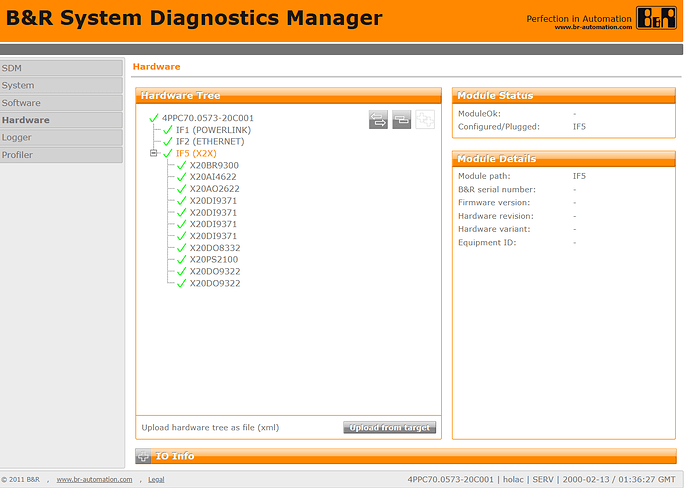

There the screenshot.
That looks good. Did you change any parameters before this issue happened? Can you get in contact with machine builder?

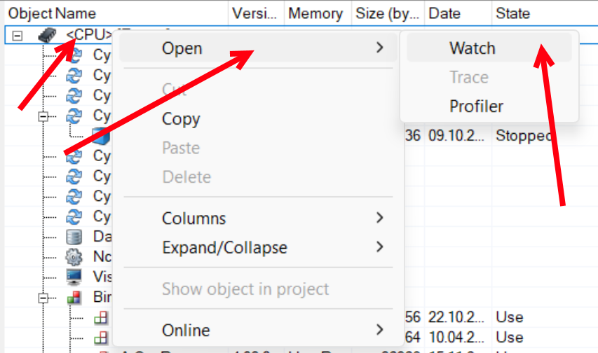

Ok that is a good hint, if the issue appeared after you changed the blade speed then this might affect something else that now causes a division by zero. Here is what you could try. When you are online in Automation Studio. Go to this setting
This will open a side by side view where you can see all tasks. Right click on the PLC and open the watch. This will give you access to all global variables.
