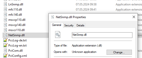

This warning is rather strange as the NetSnmp.dll on my PC (PVI 6) is digitally signed:
Hi Oliver
Mine doesn’t even have the property for signatures.

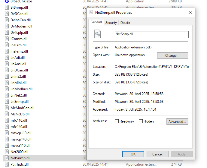

The file NetSnmp.dll seems to have its origin in the folder:
C:\Program Files\BrAutomation4\PVI\V4.12\PVI\Tools\PVIRTBin
Somehow this .dll is the only one, that has no certificate…
but i don’t know if this matters since the same file installed with the
version 4.12.6.86 (thas is working), has not certificate either…

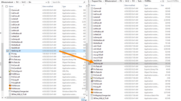

Hello Patrick,
Okay, I see the issue now. It’s not directly related to the issues I mentioned yesterday, but tangentially related.
It looks like the updated NetSnmp.dll with the digital signature was included in the …\PVI\V4.12\Bin folder, but didn’t get updated in the …\PVI\V4.12\PVI\Tools\PVIRTBin\ folder. This is likely why you see it only when generating installation packages, because they are pulling from a different folder than the normal \Bin.
As a workaround, you can replace the NetSnmp.dll in the \PVIRTBin\ with the signed version (this requires admin rights if installed within the C:\Program Files (x86)\ directory).

Hi Austin
This solved the problem.
Thank you very much for the help.
