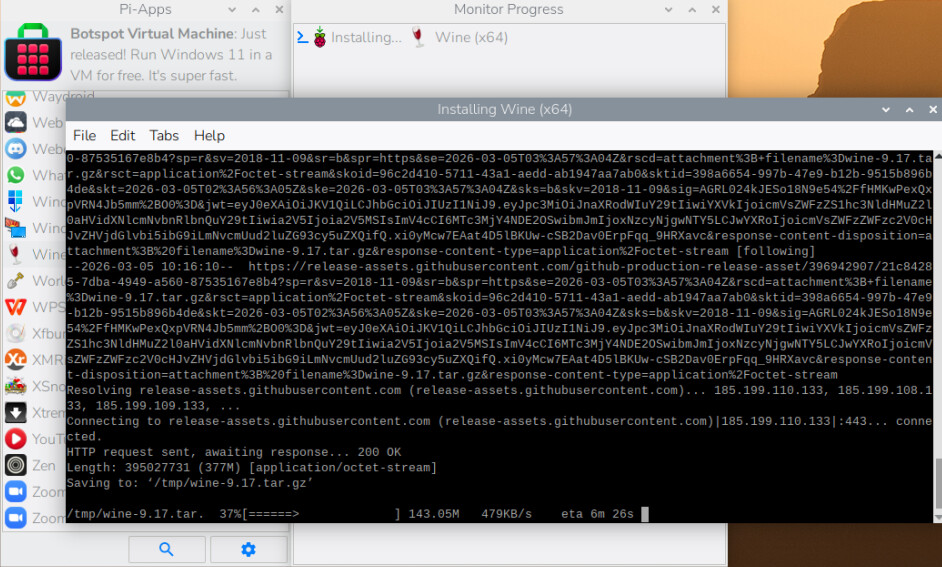

Dear Patrick,
PVI can run WineHQ by Pi-Apps: Install Wine (x64) on Raspberry Pi | Pi-Apps
Please see attched pictures
