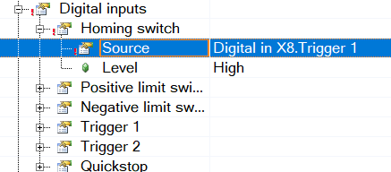

I am doing homing with MpAxisBasic, for this I selected the mcHOMING_LIMIT_SWITCH mod section. When I set homing to true, it searches for the sensor. I want the sensor to be positioned as 0 on the rising edge. How do I add the sensor to the program?

Dear Administrator, I move the servo motor until I see the sensor. How can I add the sensor to the software? I want it to stop when it sees the sensor.
the simplest option would be to connect it to the ACOPOS itself (trigger inputs) and select that in hardware tree:

Dear Sir, my inputs go into PLC. When defining these inputs, we need to select the verifiable option from the source option in this region and assign PV mapping, right?
Hi Ferhat,
yes. that should be the simplest way. But be aware you must take the delays of PLC and network into account so your homing precision will decrease.
To get rid of this you should activate the ‘ReferencePulse’. But this can also be tricky in some cases.

Hi Cristoph, I have a question about your solution with the Sensor and the homing mode:
Why did you link the Trigger 1 to the Negative Limit Switch?
Shouldn’t it be linked to the Homing Switch option?
Hello Salvador,
sure, homing switch is also possible. It depends what your requirements are.
If you take one of the limit switches then you can use them as limit switches, too.
The homing switch instead becomes ‘umemployed’ after the homing sequence :slight_smile:
Hello Christoph, I understood your point and you are right, it is a bit more convenient to use it as a limit switch. Thank you
