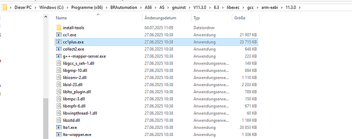

I just noticed the latter part of the error. It seems that I am missing “cc1plus.exe”.
i changed my PLC to the model from your Error Message “X90CP154.60-00”
it did compile without errors.
I think its not an issue with the Hardware. There must be some other issue.
I had a look for the “cc1plus.exe” but i can not find any statement for it in Message Window, and also in the location provided by your error message, i don’t have it.
I did use AS 6.3.1.32 , AR 6.3.2 X90-HW 1.1.0.0
I did not used Automation Studio Code much, only had a short look into it. I only used Automation Studio 6.
Can you provide more information about your test, maybe an export like mine, so we can have a better look at the code.
Update: I did now find an “cc1plus.exe” but its in an complete different location.
It looks like it is part of the compiler.
Don’t know if this helps…

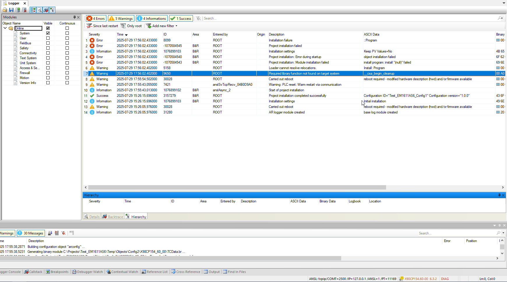

The simulation starts in Diagnosis mode. I have added the console log.
Log
$accsec:EventID 1073773104 (INFO, 0, 31280), “ROOT”, “base log module created”
$arlogconn:EventID 1073773104 (INFO, 0, 31280), “ROOT”, “base log module created”
$arlogsys:EventID 1073773104 (INFO, 0, 31280), “ROOT”, “base log module created”
$arlogusr:EventID 1073773104 (INFO, 0, 31280), “ROOT”, “base log module created”
$fieldbus:EventID 1073773104 (INFO, 0, 31280), “ROOT”, “base log module created”
$firewall:EventID 1073773104 (INFO, 0, 31280), “ROOT”, “base log module created”
$motion:EventID 1073773104 (INFO, 0, 31280), “ROOT”, “base log module created”
$safety:EventID 1073773104 (INFO, 0, 31280), “ROOT”, “base log module created”
$textsys:EventID 1073773104 (INFO, 0, 31280), “ROOT”, “base log module created”
$unitsys:EventID 1073773104 (INFO, 0, 31280), “ROOT”, “base log module created”
$versinfo:EventID 1073773104 (INFO, 0, 31280), “ROOT”, “base log module created”
$arlogsys:EventID -2147453620 (WARNING, 0, 30028), “ROOT”, “reboot required - modified hardware description (hwd) and/or firmware available”
$arlogsys:EventID -2147473998 (WARNING, 0, 9650), “ROOT”, “__cxa_begin_cleanup”
$arlogsys:EventID -2147478490 (WARNING, 0, 5158), “ROOT”, “Install: Program”
$arlogsys:EventID -1070584540 (ERROR, 48, 11556), “ROOT”, “object installation failed”
$arlogsys:EventID 1076899103 (INFO, 48, 11551), “ROOT”, “Initial installation”
$arlogsys:EventID -1070584545 (ERROR, 48, 11551), “ROOT”, “”
$arlogsys:EventID -1073733725 (ERROR, 0, 8099), “ROOT”, “::Program”
$versinfo:EventID 1076898062 (INFO, 48, 10510), “ROOT”, “”
$versinfo:EventID 1076898066 (INFO, 48, 10514), “ROOT”, “”
I did try this solution for error 8099. But for error 11556 I could not find on the forum yet. Any idea why my simulation is returning this error?
using this Compiler Setting is not a good idea. I never heard of it and after i added it i run also in DIAG mode. Checking my logger we can see that the system tries to find a Function on the PLC with the Name __cxa_begin_cleanup which is not there.

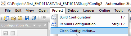

If you want to clean your Automation Studio Project Folder, you can use these Menu.
In some cases you can also just delete the TEMP Folder in the Project-Folder if AS is closed and ARsim is not running.
Please remove the build option, if you are not absolut sure what it will do and how to use it. I could not find an Info in Automation Studio help, so i can’t help here. But to tell that is made it worse on my side.

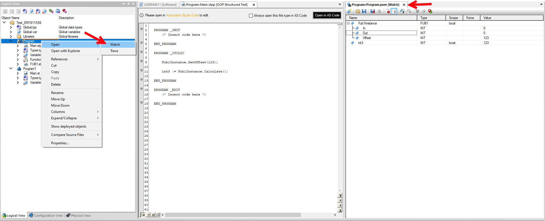

Initialising the .fub and .stpp correctly allows us to communicate easily between function blocks. The only remark on this is that in AS6 there is no variable watch during simulation for stpp files. However in ASCode using breakpoint and debug we are able to validate our project.
I am happy that you finaly got Through :slight_smile:
Thanks for the Feedback!
I got the Information that it is currently intended that all SToop Programming will take place in Automation Studio Code. Automation Studio is only the back-end and will currently not support SmartEdit or Monitor-Mode.
The Watch in AS6 can be used via the “Context menu”
