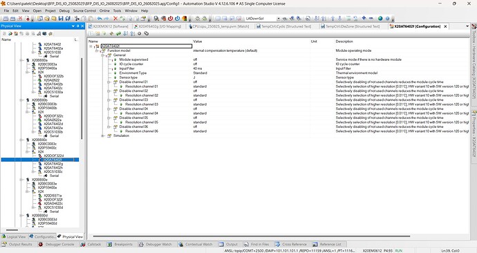

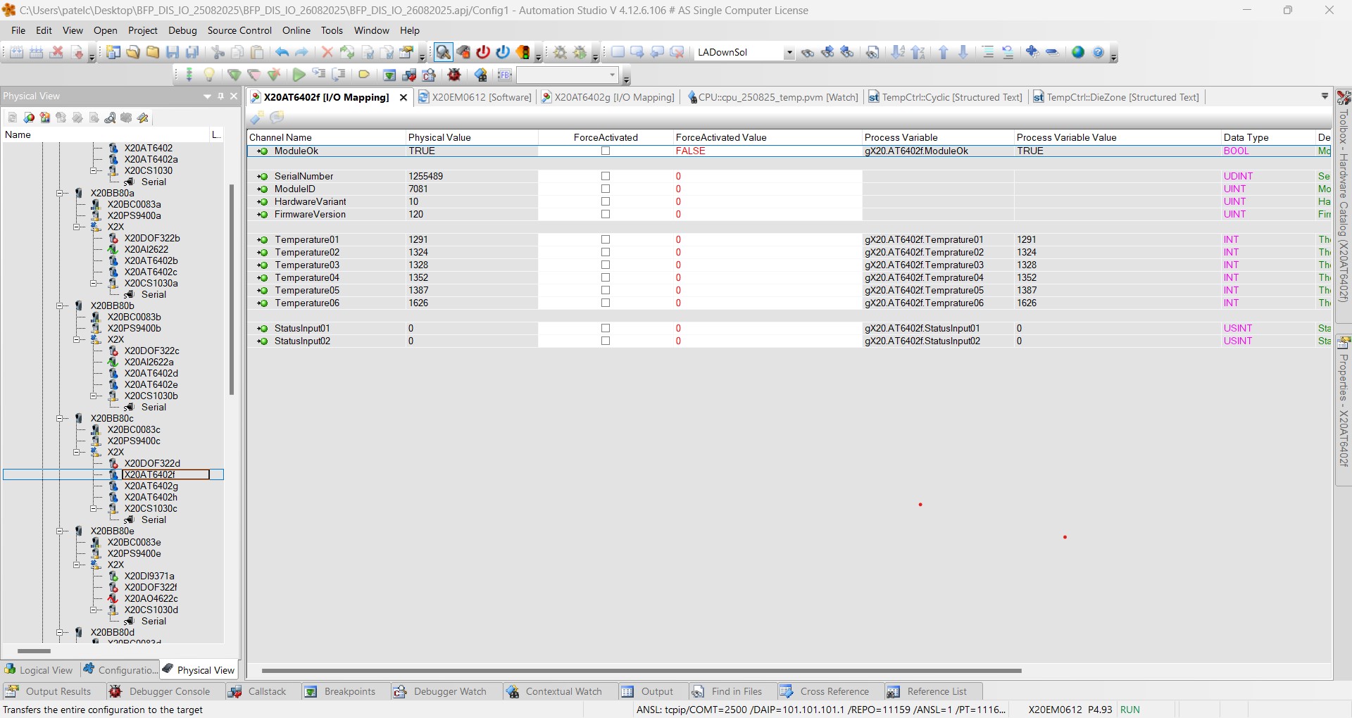

Hi Support,
I am using the X20AT6402 module configured with a J-type thermocouple. I’m Facing issue continuous temperature fluctuations in the readings. I’ve attached photos and videos for reference. Please help me identify and resolve the issue?
Thank you in advance for your help.

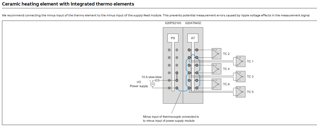

Hello Chetan,
Can you please test this wiring

No, a solution has not been found yet. However, I am actively monitoring the issue.
I’ve observed that performing a power cycle occasionally resolves the problem temporarily.
but the issue reappears after 2 to 3 days.
