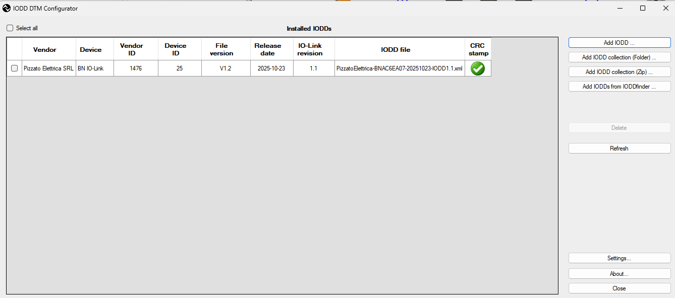

Hello, I downloaded an XML from IODD Finder for an IO-Link device I need for a project, which I then tried importing via the 3rd party device manager. It then started an automatic update of the DTM Catalog, but the device does not show up in the list. When I tried importing again, it says that an identical file has been imported previously, and when I check the IODD DTM Configurator, I can see that it is there.
I tried reinstalling AS6 and reinstalling the B&R DTM and starting everything in admin mode. Nothing worked unfortunately.
What am I doing wrong? Does anyone know how I can fix it?

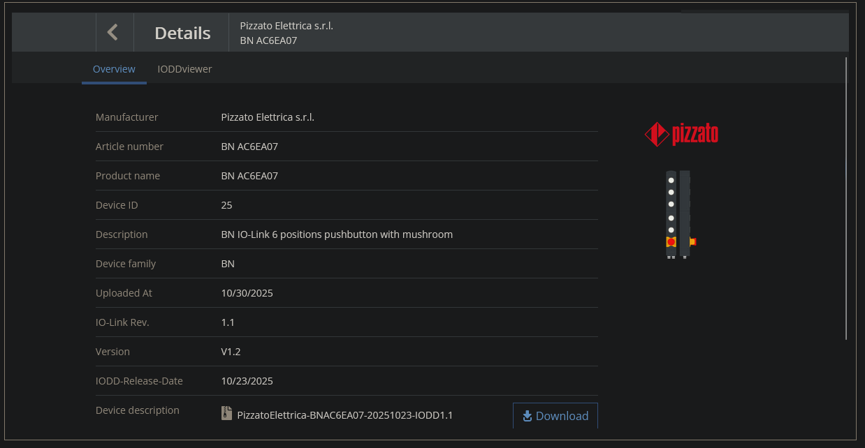

This is the device I am trying to use.
When I imported the module via the Device Manager, it only shows up in the IODD DTM Configurator and not in the device list of the device manager.
I have tried other devices, which also don’t show up.
