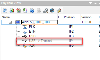

In Automation Studio, I changed AR embedded to Terminal on Subsystem for IF3 and IF4 USB.
I tried Warm restart and Cold restart and still nothing happened.
I tried it also on second panel, where is version 1.0.1 and still nothing.
Please, can you help me? I do not know what I am doing wrong.

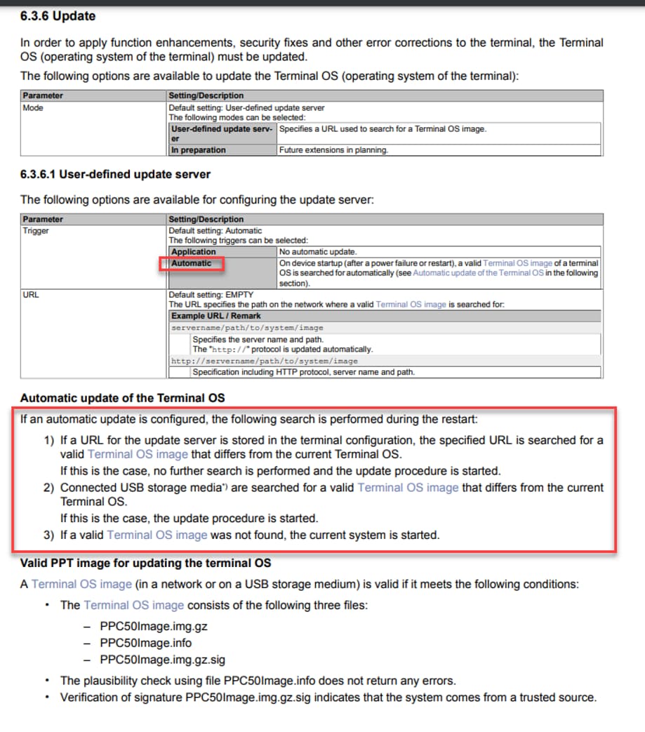

C50/update/USB
  • Download image from webpage
  • Prepare USB flash disk, FAT32
  • Copy complete update to USB disk root
  • Plug it in to USB of C50 that is assigned to terminal. By Default it is IF4
  • Restart C50, update will start automatically according to your configuration
If a USB stick is not recognized, even if everything is configured and prepared properly, try a different USB stick (a different brand) the best from B&R
