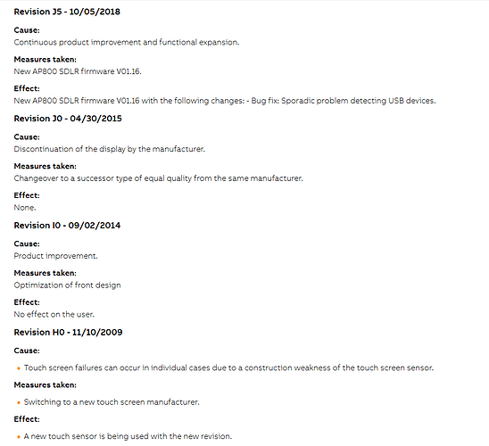

here is the Revision History from B&Rs homepage:
Apart from a USB issue which was fixed I would say yes
I agree with Oliver. Usually, the model number is important. The revision is kept backward compatible if possible.
