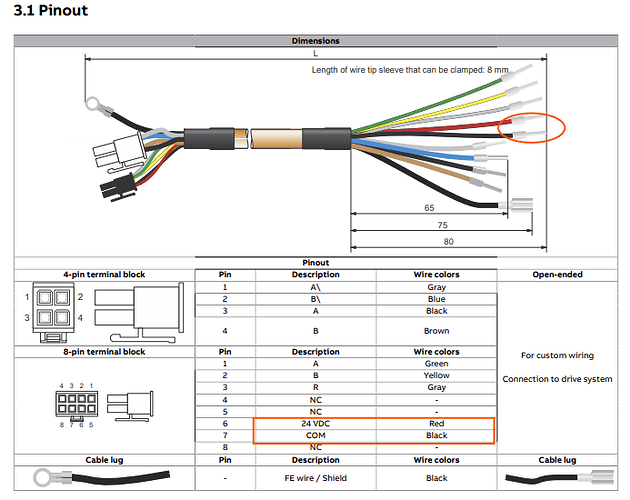

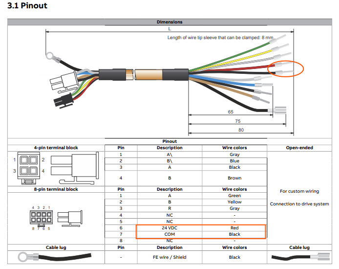

Besides that, where do I connect the Red(24VDC) and Black(COM) wires of open-ended Hybrid cable(80CM03013.21-01)

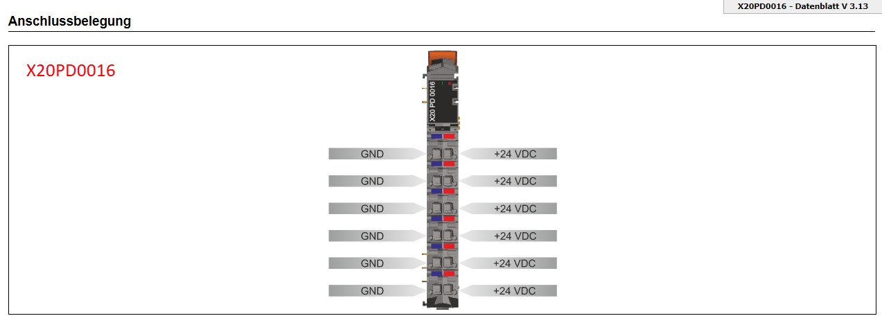

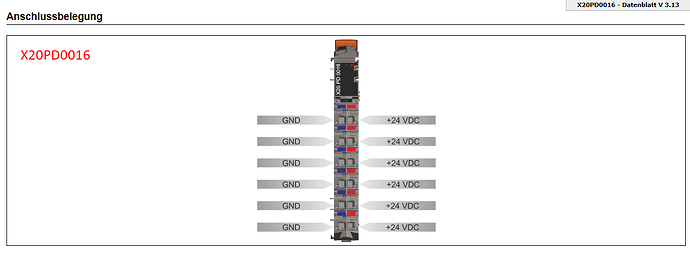

To supply the encoder with 24V you can use any 24V source.
  • You can extend the wires and connect them to an different Terminal.
  • You can use X20PD0016 to have a terminal next by (external supply)
  • You can use X20PD2113 to have a terminal next by (IO-Voltage supply backplane)

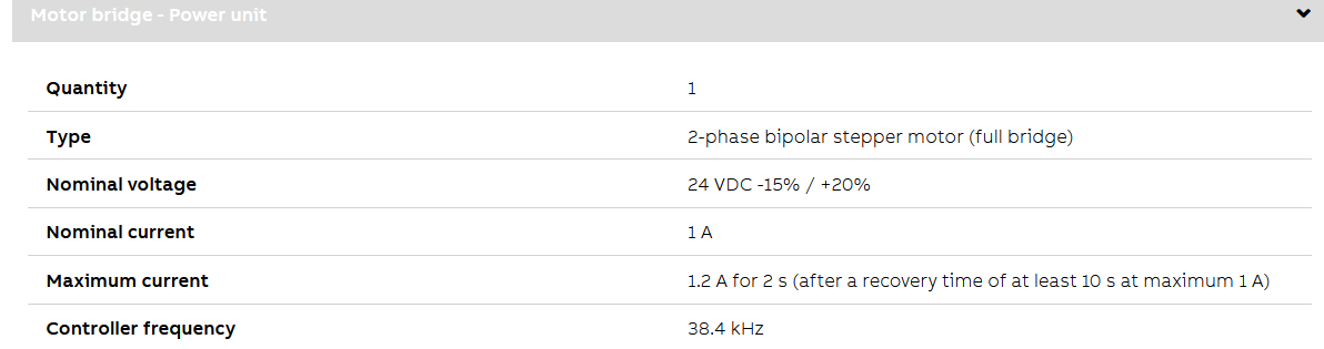

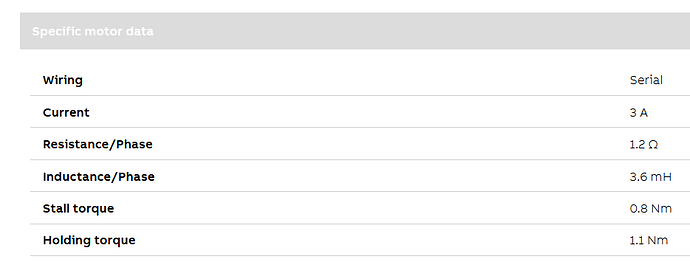

taking the data sheets from the motor and the stepper module, I would configure the currents as following:
The 80MPD1.300S014-01 has a max. current of 3A.
The X20SM1426 allows for a max current of 1.2A at 2s max time, while 1A can be used without any restrictions.
Standstill Current: 0,5A
Constant Speed Current: 1A
Speed Change Current: 1,2A (if still under 2s)
Regarding your wire connections, both need a connection via an external 24V DC supply, as the X20SM1426 module has no supply for the encoder included.

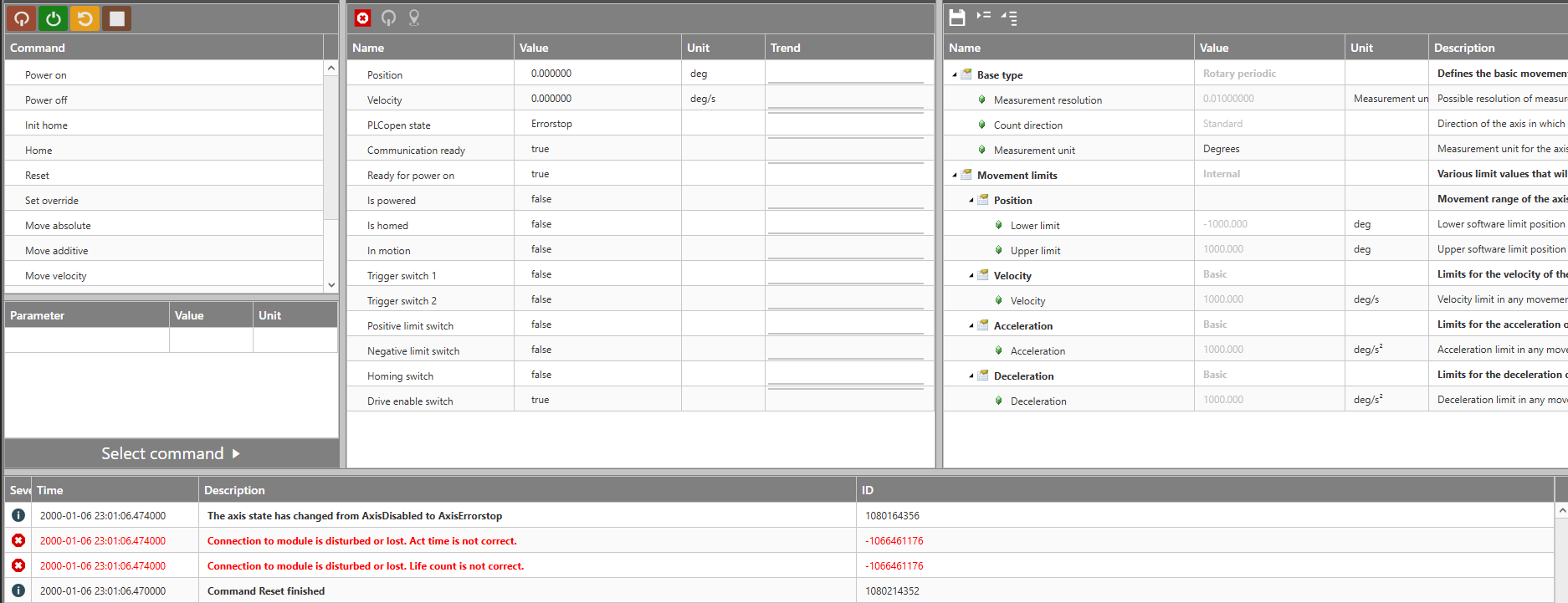

Hi @JulianL and @michael.bertsch,
Thank you very much for the advise. I have wired the 24VDC and COM to the external power supply.
I continued with the configurations(Pictures attached). After I download my configurations. I tried to “Power on” the stepper, I am getting an error “-1066461176”
I tried open using mappCockpit. I still get the same error “-1066461176”
I am checked my wiring, I am pretty sure it is correct. Because the hybrid cable came with the 4-pin and 8-pin connector. I have wired according to the datasheet/manual and AS Help.
I could not troubleshoot any further, hoping to get some advise from the forum as well.
Thank you in advance.
See Chapter 3.3.1 Timing of my Commissioning guide.
If the Timings of TC#1 , PLK , X2X are not synchronous. This error can occure, as the system internaly sends timestamps and checks them.
In Generall you can Start from Chapter 1 to ende. There are a lot of other infos.
Hi everyone,
Thank you for the replies, suggestions and resources.
I was able to solve the error and also clear regarding the wiring for the 24VDC and COM.
Appreciate it a lot
