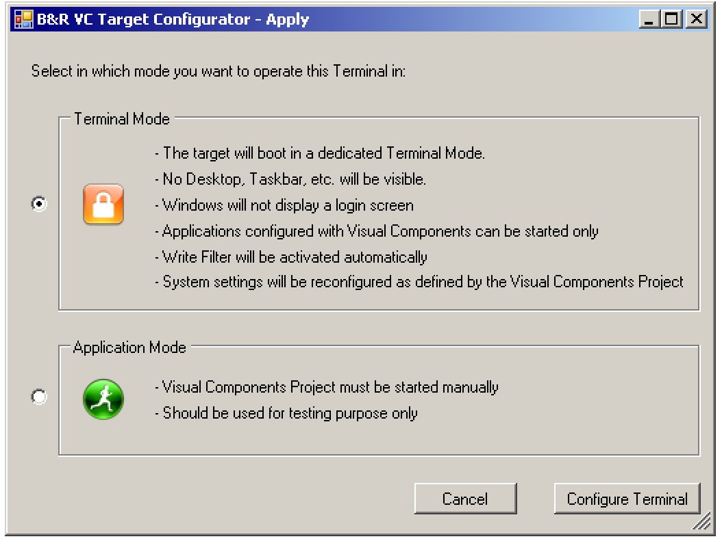

Hi Michael,
yes, the terminal user makes the following adjustments.
But you can also start VCWT in application mode. In this case, you have to do the adjustments yourself. I am not sure about
