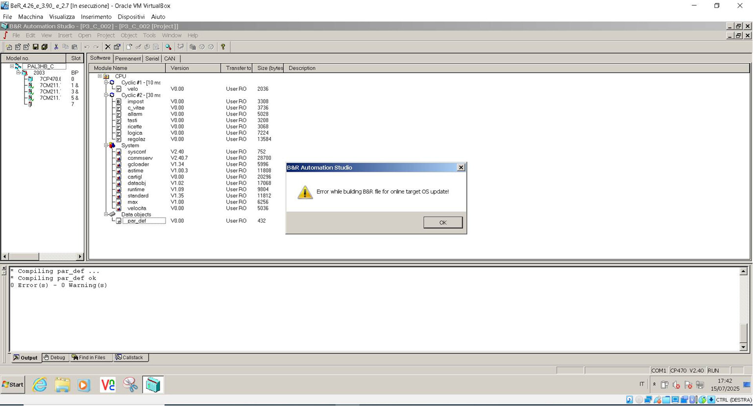

we are using AS 2.7 and we are connected via RS232 to a 7CP470.6.
After the build we got this error (see image below):
We are able to download succesfully to the target but we would like to avoid this message.
Any idea?
Thanks!
Giovanni

AS2.7 is quite some while ago and I am not 100% sure about this error.
best regards
Oliver
How can we check if ARV2.40 is installed?
Thanks!
Browse to your AS installation and take a look at the “system” folder where you should find a V0240 folder
