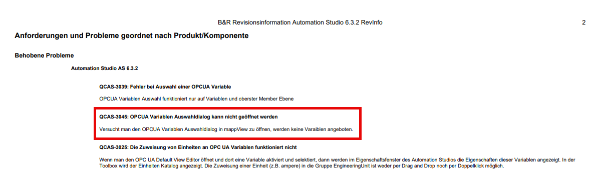

I have encountered an issue in a project and currently see no way out. Suddenly, the OK button in this dialog stopped working.
It remains perpetually grayed out. Deleting the temp folder does not resolve the issue.
The project compiles without any errors or warnings.
When I open another project, however, the button functions correctly…
Has anyone observed this behavior before and knows of a solution?
P.S.: All installed versions are up-to-date.
Some of my colleagues have encountered the behaviour as well. But we currently also have no idea why this occures. The issue seems to be situated in the Editor Window.
The known Workaround ist to create the OPC-UA Path by yourself and enter it manualy into the Widget Setting field.
We are in contact with your Sales Manager and will disscuss this with the B&R Support to provide an clarification.
I am also looking forward if other community members can contribute to this topic. Did you also have had it, or do you know how to reproduce it, …
Michael Bertsch
Upon further investigation, while attempting to replicate the issue on an alternate computer, we observed that the OPC UA C/S technology package, version 6.3.0, is no longer available for download. I had successfully downloaded and installed this version earlier this Tuesday.
This anomaly prompted me to revert to the previous version, 6.0.0, via the “Change runtime versions” setting on my primary machine.
Remarkably, the functionality of the OK button was immediately restored.

Servus,
i actually run in the same Problem
Brandnew Project
AS 6.31.32
Most recent Library Versions as far as available.
After playing around a while i must confirm that only
Changing the Runtime version of the OPC AU C/S Package to 6.0.0 (intermediate Version 6.3.1 same issue)
solvels the Problem

Hi there,
as far as I am aware, this issue should be resolved with AS >= 6.3.2, where AS 6.3.4 is the most recent available version, see https://www.br-automation.com/en/downloads/software/automation-studio/automation-studio-6/automation-studio-v6/
RevInfo for AS 6.3.2:
