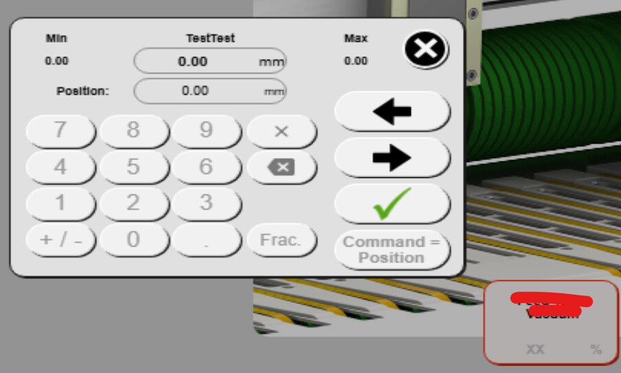

All the required upgradations are completed for AS4.12 to AS6. While simulation testing, In mapp view all type widgets are not displays properly. Eg. In Numeric pad its Shows XX, not able to enter values or not able close the numeric pad. Same type errors occurs for all widgets used in mapp view. Is AS4.12 mapp view working fine without any issues.

I am facing the same issue (with numpad XX) in anonymous token and Fixed User.

Thanks for your response. Still the issue was not resolved. I have upgraded the configuration as per suggestion mentoined above. I can still see the OPC UA not able to connect.
And I Can still see the values in the widget is XX only, numeric keypads are not getting popup.

I tested this on my side and when I had nothing defined, I saw the “XX” for the NumericOuputs. After adding my role and setting “Read” to “Enabled”, I was able to see the NumericOutput widget values populate.
Furthermore, make sure that all the variables in the Default View that you are attempting to display are inheriting these permission settings (this should be set by default).
