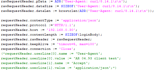

Hi Alexander,
Thank you for your response, i have sniffed the API request made with curl and indeed there is an extra header.
i added this to the header via the user line and via the added raw header, both without success.

I fixed it!
The problem was that I was calling the httpClientInst.requestDataLen := SIZEOF(x), when it should be brsstrlen(ADR(x))
The content length was 256 instead of the actual USED content length(61 in my case), therefore asHttp function would put many “********” after the body to fill it to the content length of 256, which the API of course did not accept as a valid body.
Below this is the final code that works for me if any time travelers in the future need it:

	loginBody := '{"name": "admin", "password": "781b9c2264383b453b40fdbf8a7e"}';
	rawRequestHeader.pData := ADR('User-Agent: curl/8.14.1\r\n');
	rawRequestHeader.dataSize := SIZEOF('User-Agent: curl/8.14.1\r\n');
	rawRequestHeader.dataLen := brsstrlen(ADR('User-Agent: curl/8.14.1\r\n'));
	requestHeader.contentType := 'application/json';
	requestHeader.protocol :='HTTP/1.1';
	requestHeader.host := '192.168.3.11';
	requestHeader.contentLength := brsstrlen(ADR(loginBody));
	requestHeader.rawHeader := rawRequestHeader;
	requestHeader.keepAlive := 'timout=5, max=100';
	requestHeader.connection := 'Close';
