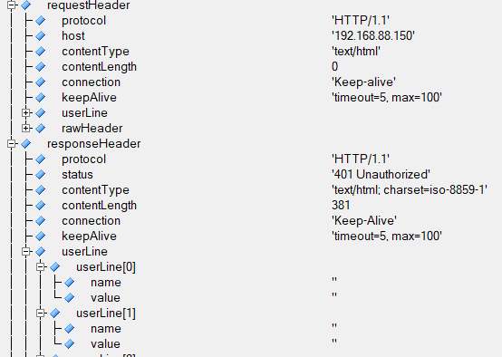

Here’s where the issue arises with my camera: the full response header contains authentication parameters (e.g., realm, nonce), which I can see in an API testing tool. However, my client (httpClient) receives all the connection data but not the authentication data.

You are completely right, but in reality all connection information is received except the authorization data.
The full data looks like this (send via Postman):
but the headers requested and received by B&R httpClient:
does not contain the authentication data.
That’s why I’m asking whether anyone has experience with exchanging authorization data via HTTP headers. From my point of view it’s doesn’t work.

I can’t see any name setup in your userLine[0] of the responseHeader - you have to set a name there to advice the functionblock to parse the header for the value.
For example if you want to get the value of “Server” from the response header, you have to set userLine[0].name := ‘Server’ before calling HttpClient().
This would be the same way for “WWW-Authenticate” - but as the value seems to be very long, I think it does not fit into the .value[0] field (which has STRING[80] as I remember).
So, are you using rawHeader (I can’t see in the screenshot)?
If not, please configure rawHeader like:
rawHeader.pData := ADR(myHeaderString);
rawHeader.dataSize := SIZEOF(myHeaderString);
… and declare “myHeaderString” as array of STRING[80], for example STRING[80][20] → this declaration is not mandatory, you need just a string / USINT array that’s long enough to store the whole header. But declaring so, it gives you the possibility to open the string array directly in a watch window without cutting information off.
Is even doing so no addtional header information available?

thank you very much for your help! I had completely misunderstood the concept of userLine, but now it’s clear.
