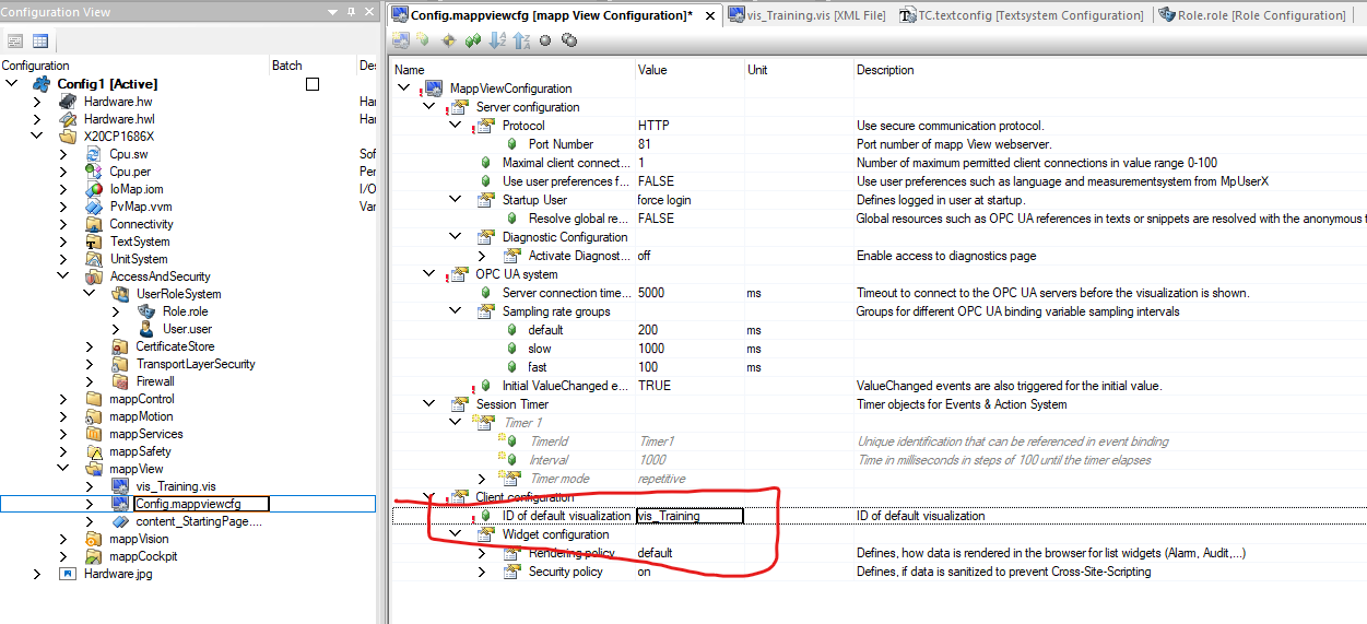

We are using mappview, and when accessing it through Chrome, the tab name is fixed as “Visualization XXXX”. Is there a way to change the word “Visualization”?
Hello.

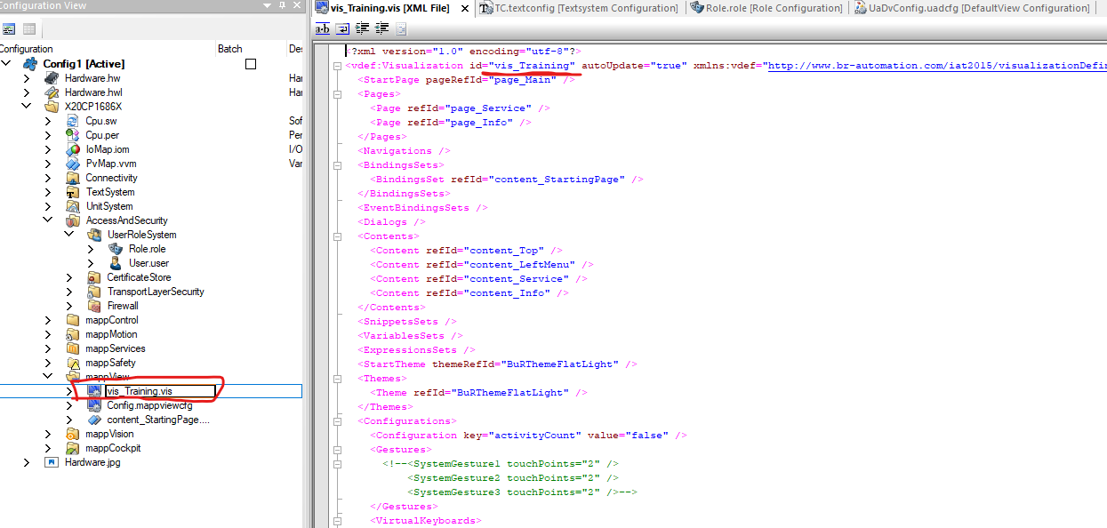

It is visualization id in vis file:
Don’t forget check default visu id in mapp View configuration:
If I understood the question correctly, you were answering the wrong part. He is aware that the id is part of the name - his issue was with the first part of the tab, namely “Visualization”
So while he has “Visualisation hdbs”, he wants “Something hdbs” (with Something being my own placeholder)
Ah, you’re right. I misread this. So, I think you can’t change it because it’s an automatically generated name.

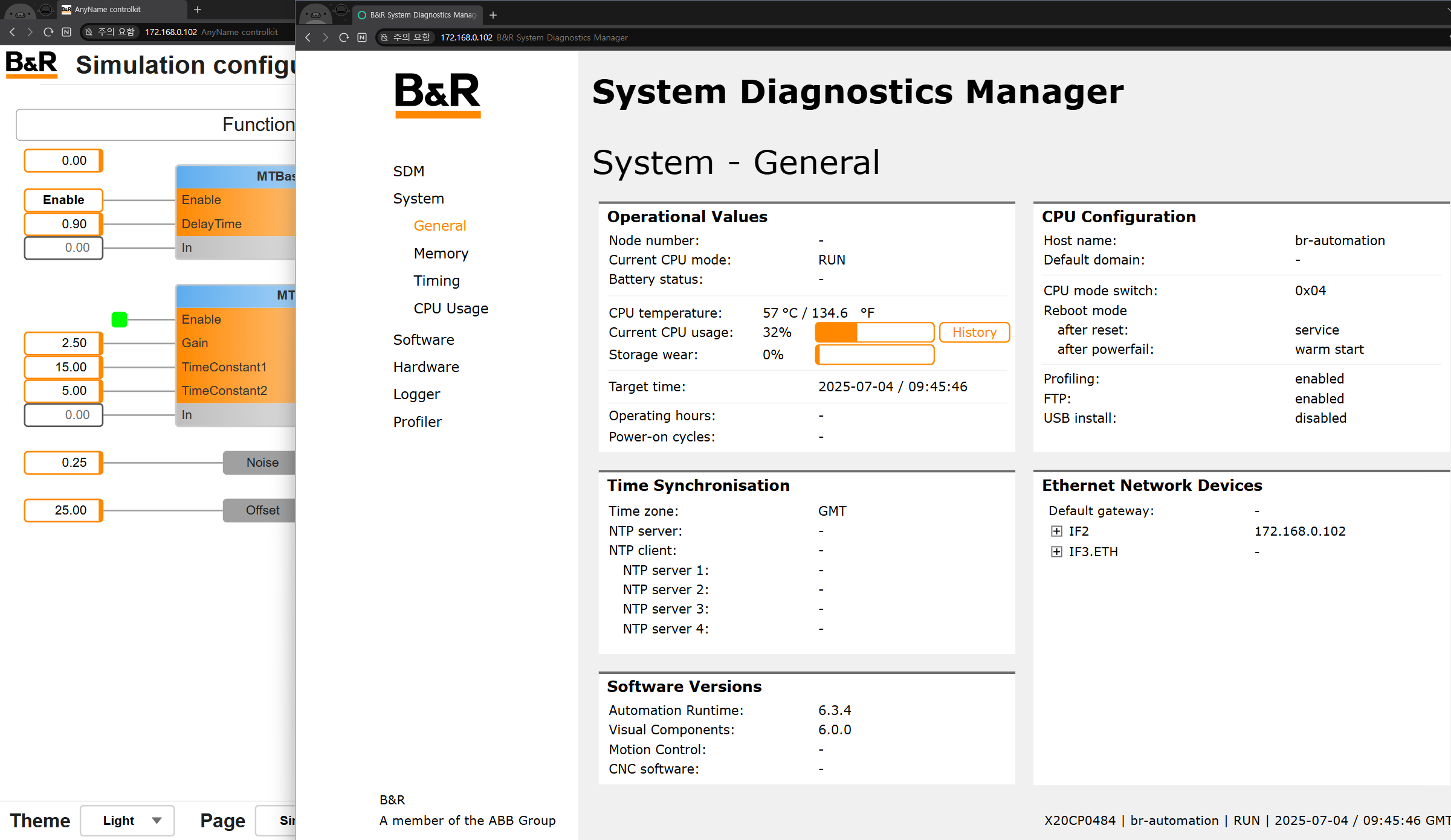

I tested at ARemb environment. And it working well.
:warning: Notice
This method modifies the build data. So, the user should understand below.
  • B&R is not responsible for this.
  • This method complicates version management.

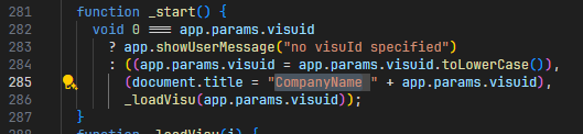

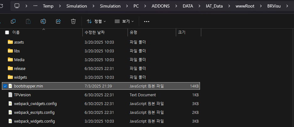

ARsim

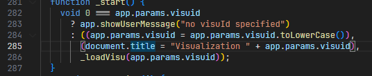

  • Find bootstrapper.min.js
  • We can find the location where we want to modify with the title keyword.
  • The title of the webpage connects the fixed string of Visualization with the visuID.
  • As an example, I changed the Visualization string to CompanyName .

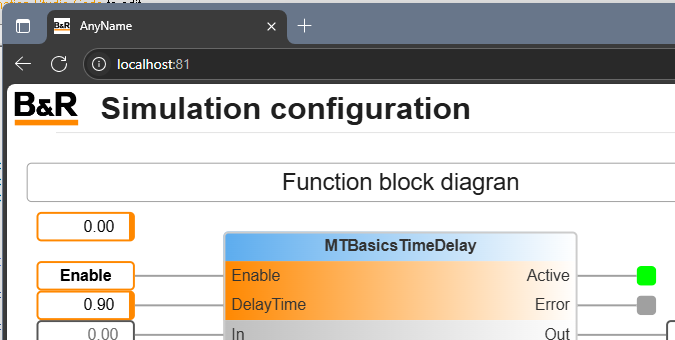

  • After save the modified javascript file, we can check the changed title by running ARsim.
    Title changed

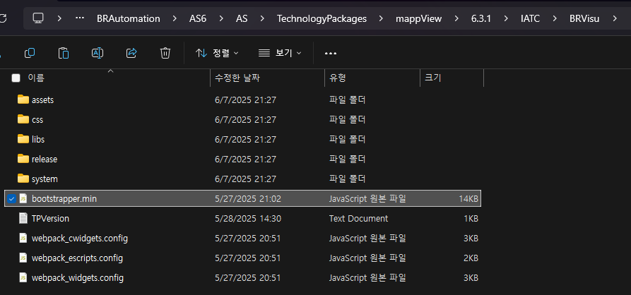

ARemb
    • Path: /C/ADDONS/DATA/IAT_Data/wwwRoot/BRVisu
  • The subsequent process is the same as the ARsim.
The source of the file modified above can be found in the path below.
