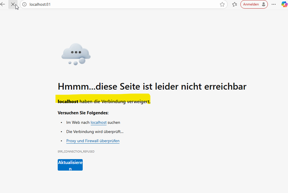

Can't get to the ARSim web site
@alexander.hefner @hobi72 so I am back at this again..
I have setup a brand new W11 VM, and installed nothing.. not even a windows feature or any updates
I put the ARSim app (c:\temp\wls2 as per requirement) and it starts ok . .(goes green)..

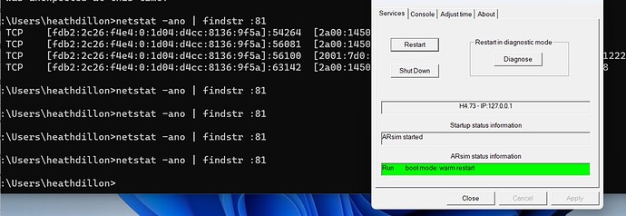

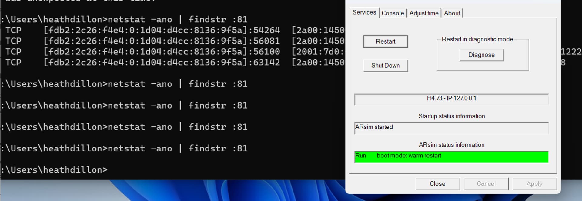

On the suggestion above, I started the app, and then looked to see if anything is listening on 81… and its not..
As you can see above, IP6 initially had something, so I disabled ip6 and nothing is listening on IP4 on port 81
So I figure what the heck.. created the VM again, but this time installed IIS and re test to see if anything was better.. and still nothing
I renamed the temp directory to see if I could get that popup allow the app through the firewall as suggested, but no luck either..
So I a now stuck … I don’t know what to do to enabled(?) port 81 to be listening… I would have through the Arsim would do all that….
Any further tips to try ?

Could you please generate a system dump with SDM (creates a tar.gz package with some information of the PLC) and a complete output of netstat (without filtering for a specific port, just forward the netstat console output to a text file), and upload both files here?

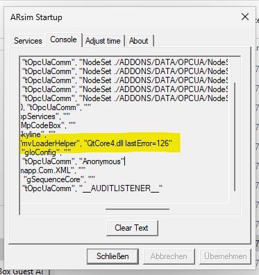

I’d also check the “Console” tab of the ARsim windows - it should contain some messages related to mapp View. Maybe there is something indicating why it did not start.

Hi @heath.dillon and @hobi72 ,

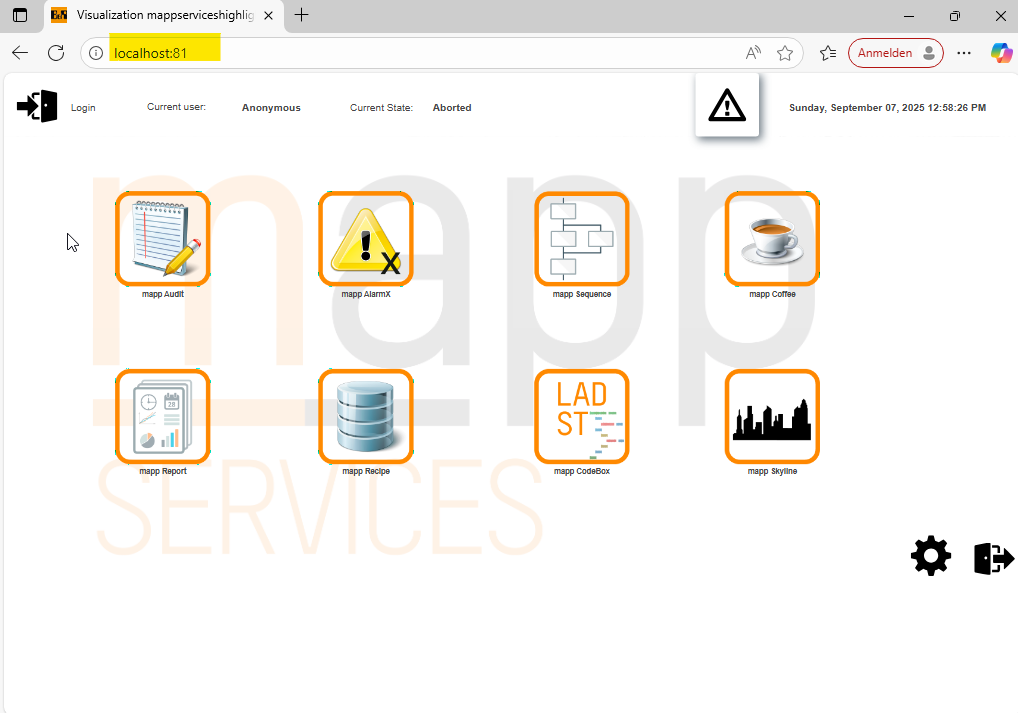

because the issue didn’t leave me alone, I tried to reproduce it - and at least I found something that looks quite similar, even if I’m not sure if it’s the same cause.
I installed a fresh, bare Windows 11 pro 24H2 as into a VirtualBox VM on my private device, and copied the ..Temp\Simulation… subfolder from a mappView project using some 4.73 Automation Runtime on it. And yes, after doing so, AR started, everything looked like expected (Ar was in run, SDM was reachable) but mappView wasn’t accessible by localhost:81.
So I digged a bit deeper into and tried several installations of Microsoft .NET and VC++ redist packages used also by Automation Studio setup, but nothing changed.
After having a deeper look into the console output of ArSim, I found one entry that wasn’t clear to me: a message about a QTCore4.dll error.

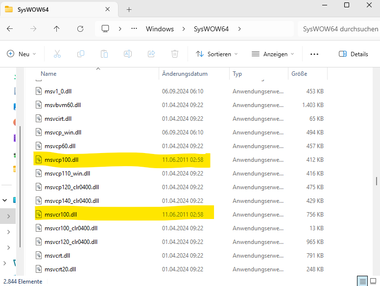

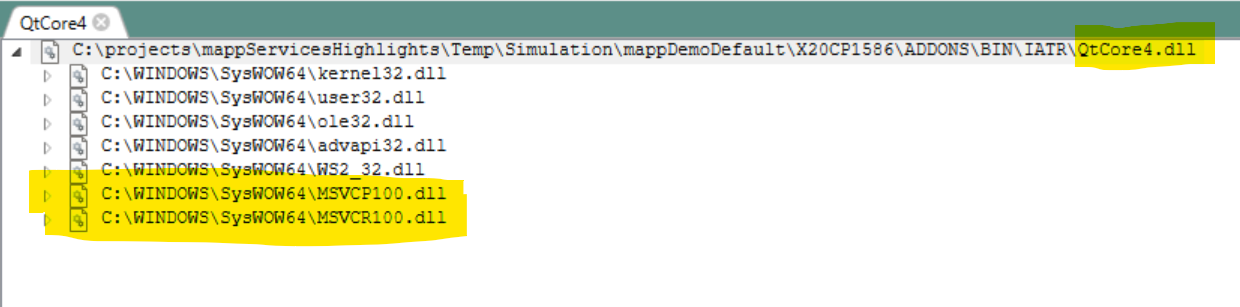

This DLL (and many others) are part of the Simulation folder, so I ruled out that that this DLL is missing. Nevertheless, as Windows DLL error code 126 often means “some ressource is missing”, I inspected the QTCore4.dll static dependencies and checked what’s available on my W11 VM installation: two DLLs were not available in the Windows\SysWOW64 directory, msvcp100.dll and msvcr100.dll
Google said, those DLL are part of an older MS VC++ resdist. package (2010 SP1 and later). As I found both on my WIndows 11 development system in Windows\SysWOW64, I just copied them to the same path of my W11 inside the VM.
And finally, after restarting mappView was accessible after starting ArSim.
I hope this information helps a bit (even if in the console output of last year there wasn’t such an error message). Best regards!

Magic !!! Awesome…
After installing Visual C++ 2010 SP1 it works… 100%
I could not get the latest redistribution to work but 2010 sp1 did
Thanks so much !!!
