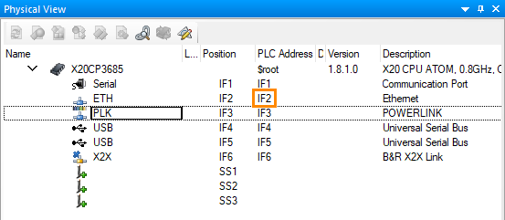

what is the bond name? where can i find it?
The bond name is the primary ethernet interface’s “PLC address”. If you are using the built in Ethernet interface of a X20CP3685 for example this would be “IF2”.
thank you. it is working.
