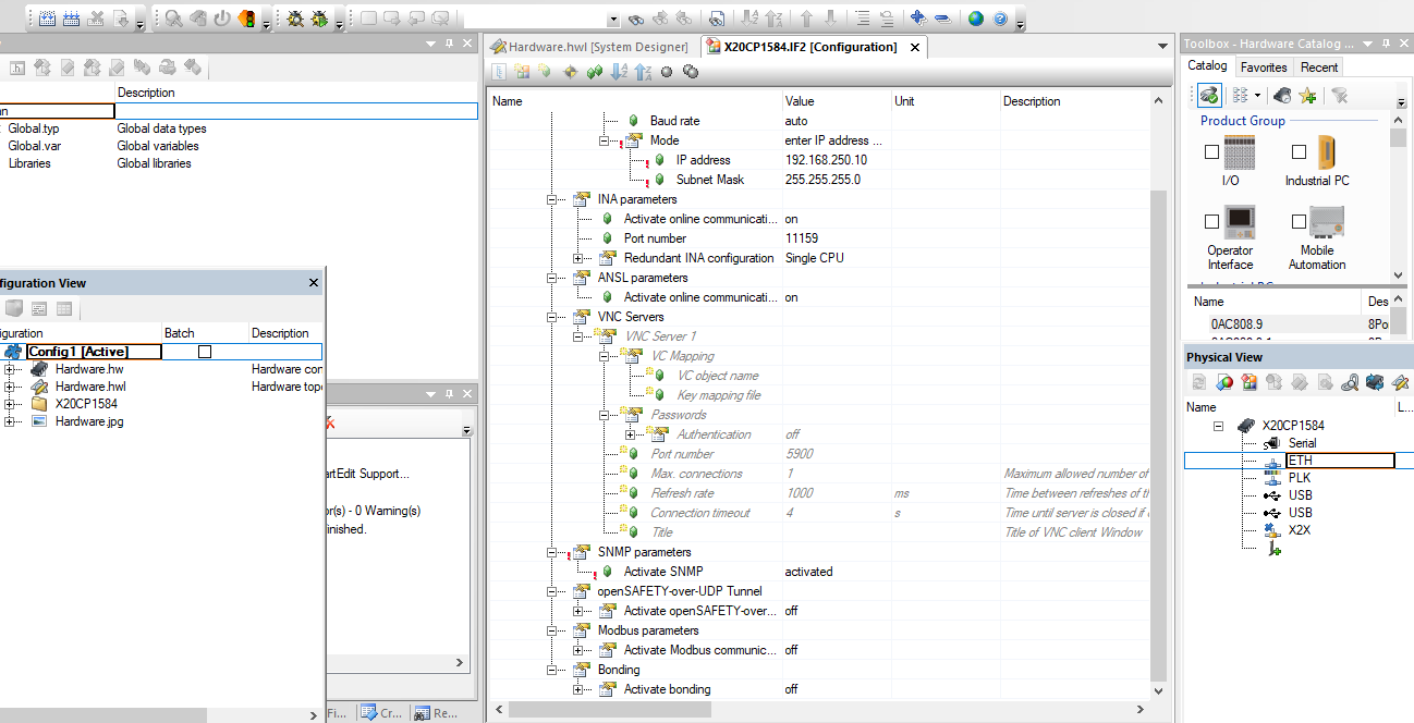

Please post a screenshot of the old projects ETH settings and of the new ones
I can’t send anything from the original project because we don’t have the source codes, but we do know the IP, that the SDM is activated and that the VNC server is also configured for Panel T50, only that we don’t use the panel, it is uninstalled and we connect with REAL VNC server with the same IP as the T50 Panel, perhaps this is why we disconnected the Ethernet cable on the PC by mistake while the project was running and this could have created a conflict.
Here I send you a photo of my new project without configuring, only IP the SDM and the hardware.
Let me tell you that I only needed to disconnect my device from Ethernet (not turn it off) and when I reconnected to Ethernet my device no longer had any traffic. Then I tried to remove power and restore it and my device keeps restarting and does not start.
Right now I can’t even transfer a blank project.
All the time rebooting.

If you’ve transferred a project with those settings, you should be able to browse and connect via Automation Studio as long as your PC is on the same subnet as the PLC. I notice that you’re in simulation in your screenshots. You won’t be able to connect to the PLC while simulation is active, so make sure to turn this off before connecting.
