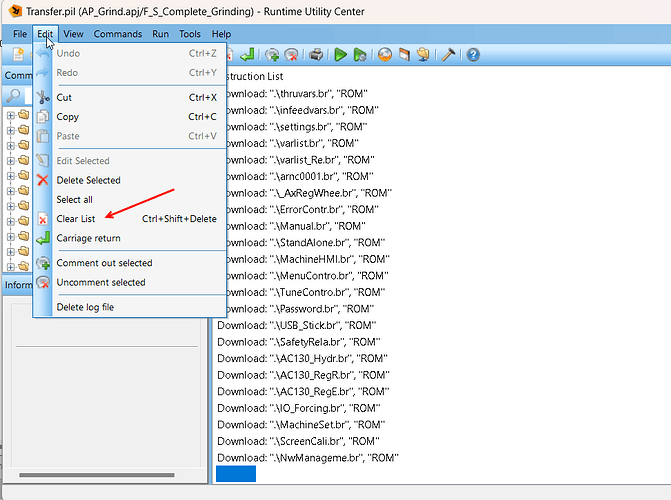

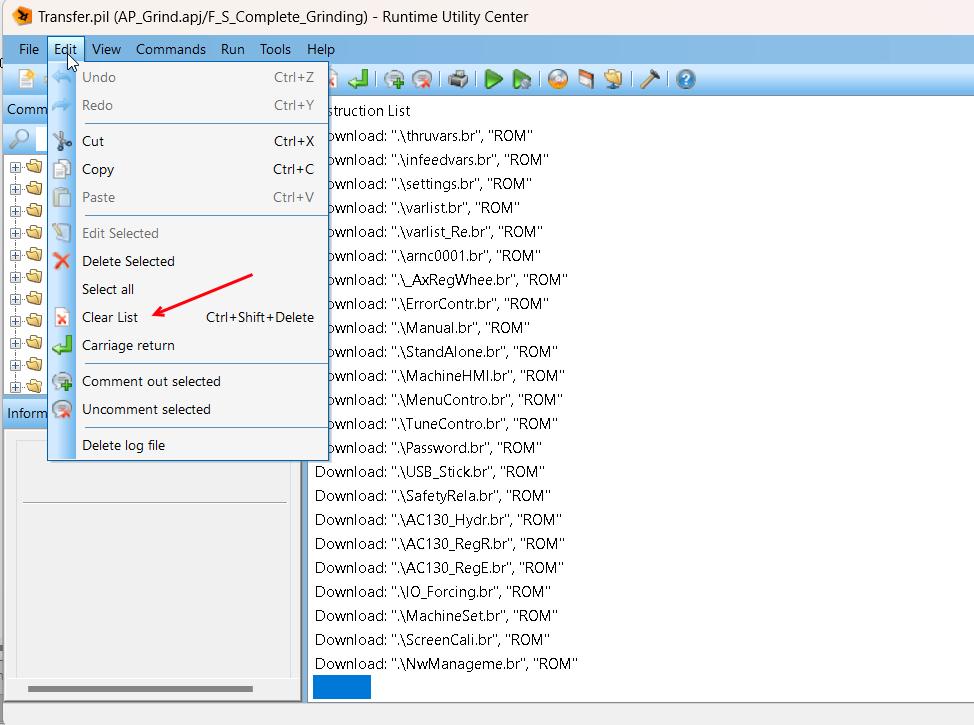

Option B) Runtime Utility Center
Can you ping the machine? 193.98.226.9?
if yes open RUC: Tools > Runtime Utility Center
then click on “Create,modify and execute projects (.pil)
Clear list:
Add a connection line:
Add logger line:
You should have similar list of instructions:
then press F5 (Execute)
and press Yes.
You should see the system logger saved on your selected folder.
Please upload that file
