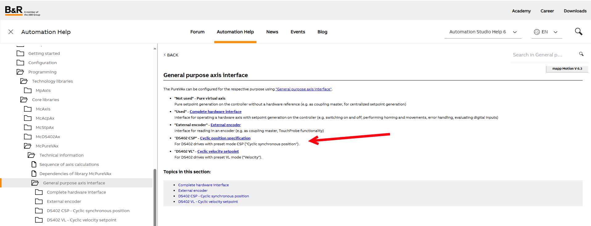

I’m developing a new project, and I need to use ethercat to communicate with ethercat drivers.
Any news about DS402 support with ethercat?

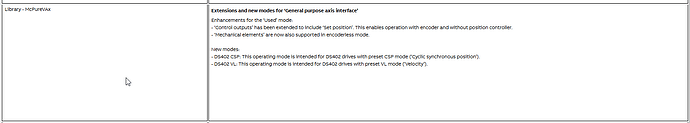

The AS6.3 software version has been released. Mapp Motion is also version 6.3. But it seems that the support for EtherCAT axis motion has not been seen yet? Is there any news or plan?
The Support was not implemented in to the DS402 Library. Instead the McPureVAx Library was extended in its functionality of the General Purpose Axis Interface. This interface can now be used to Support DS402 compatible 3ten Party Devices.
AS-Help Version Information Mapp Motion 6.2
AS-Help Documentation McPuveVAx
As far as i understood, you have to use a normal DeviceDescription File for your EtherCAT Drive. Then you have to create a Task with the nessesary Variables and they can then be coupled to the mapp Axis via the Configuration of the Gerneral Purpose Axis Interface.
Please have a look at the Help Pages.
