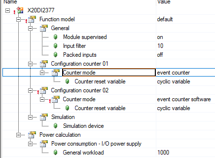

Ok, I’m trying to use the X20DI2377 which has event counters and 2 digital inputs but when I try it in simulation and modify the values of the DIs the event counters doesn’t increment, am I misunderstanding the functionality?

I’m not fully clear on the application—if you can share more details, I can provide a better answer. On the X20DI2377 module, the counter runs on the module itself: it counts pulses directly and provides the accumulated value, which you can reset via the ResetCounter output. In contrast, with the X20DI9371 you’d need to implement the counting in the PLC, and the fastest practical pulse you could handle would be about 2 ms (≈1 ms high + 1 ms low). The X20DI2377 does not have that limitation.
please be aware that all functions which are done by the X20-Module Firmware are not simulated in ARsim. If you like to check the behaviour of an IO-Module i think you need one at your desk.

Thank you @Jorge_Nunez and @michael.bertsch both answers gave me great information, I think I’m going with the X20DI2377 I just need something that doesn’t misses an input pulse and if I understand it correctly the X20DI2377 does just that I just have to read the Counter register before it fills up, I will also read into the NetTime functionality.
