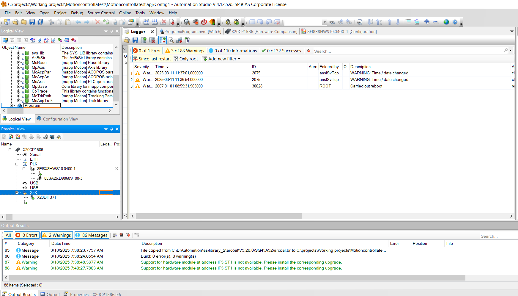

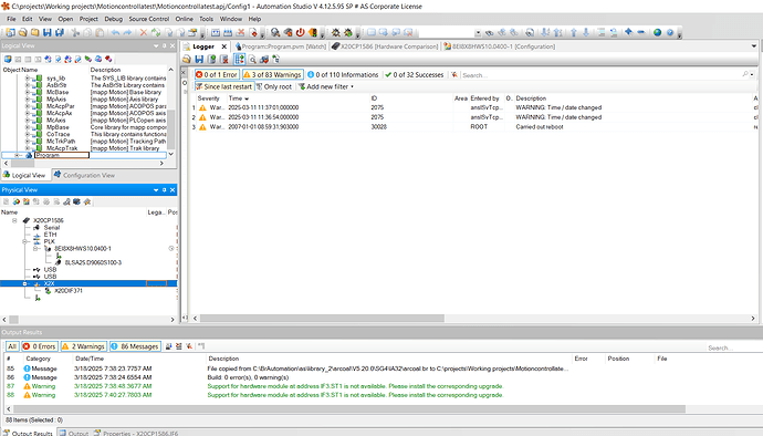

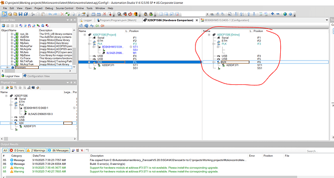

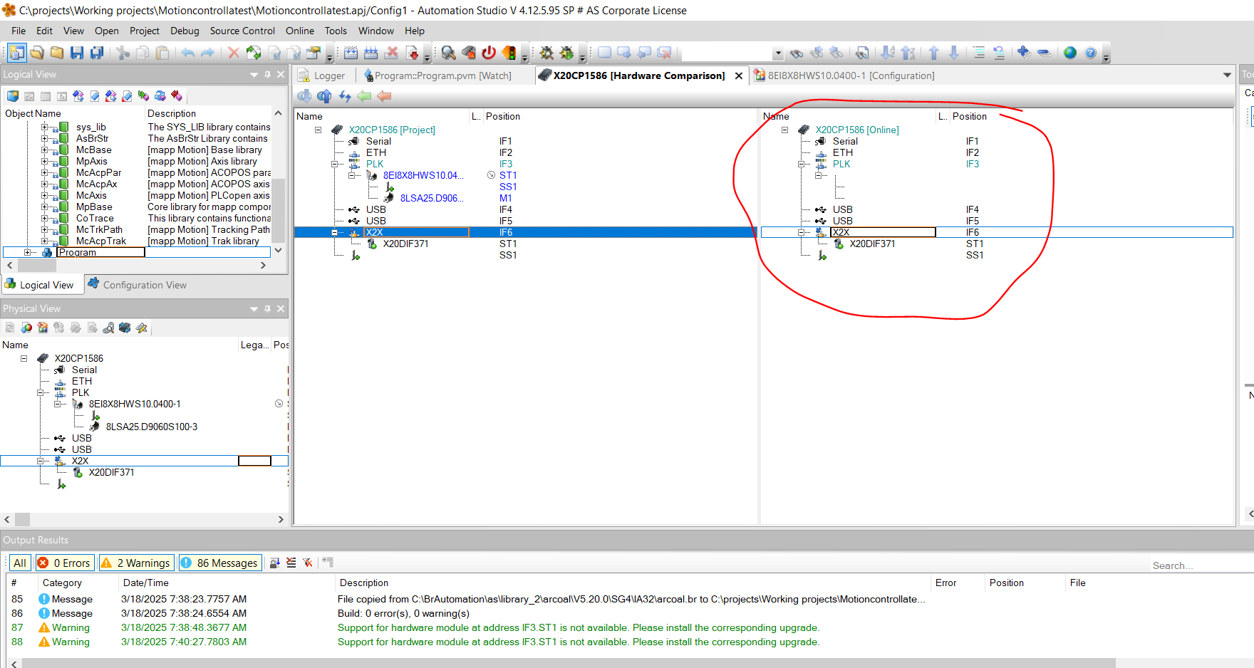

Getting error ID : -106732818 on logger
Still getting the same error message.
Also, the drive and the motor are not seen in the compare window.
Acopos modules are not displayed in the Hardware Comparison (see Limitations).

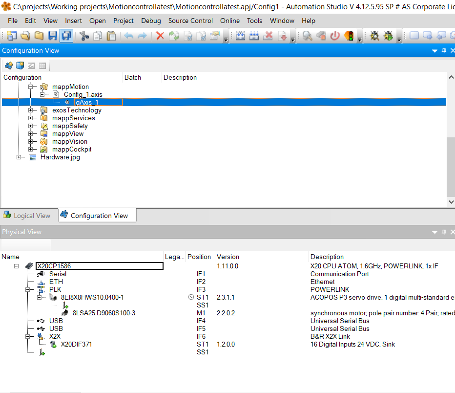

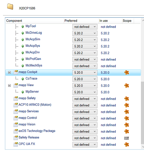

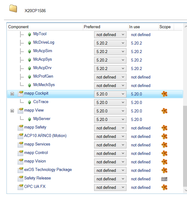

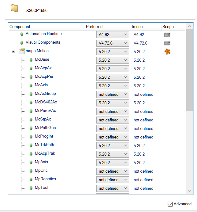

The screen shots below shows the versions of the software used. Let me know if you have further questions.

I changed the Automation run time version from K4.93 to A4.92.
Drive version from 2.3.2.0 to 2.3.1.1
Motor version from 2.2.0.1 to 2.2.0.2

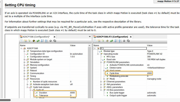

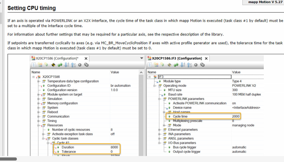

For CPU timing I followed the setting from the help menu as seen below.

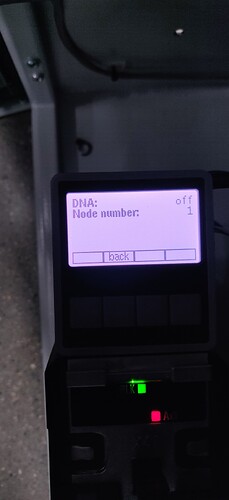

The node for the drive was set to 1 and DNA to OFF on the drive.
