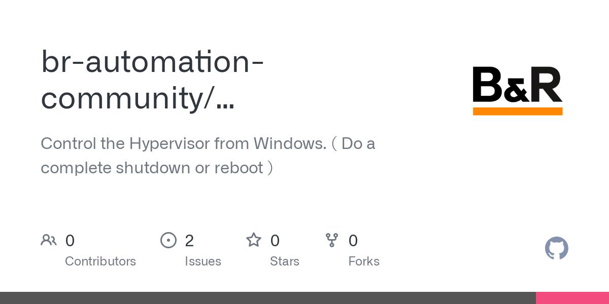

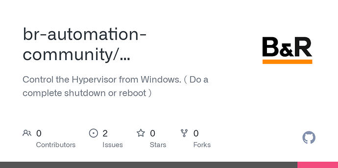

If you should make use of the C-API, you can probably also directly use the function
brhypsrvSystemShutdown from the brhypsrv.h.
See also the HypervisorControl-win on Github:
