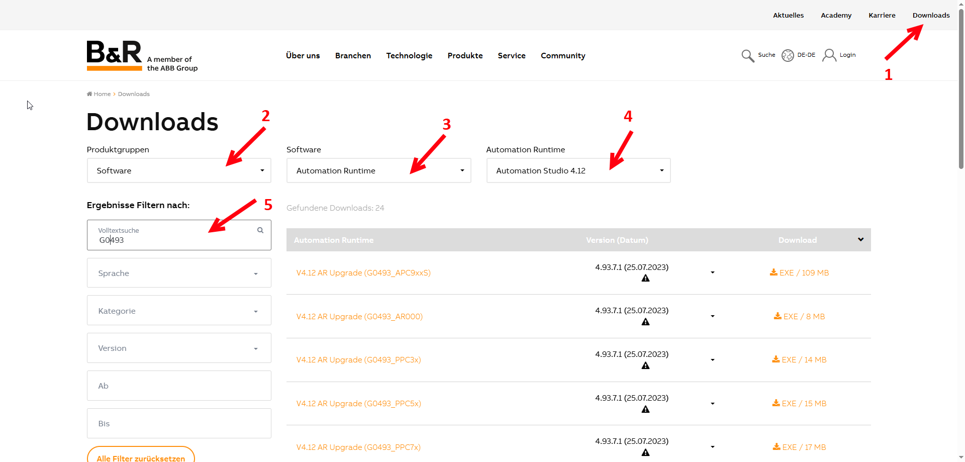

If a Upgrade is not shown in the Automation Studio Upgrades Dialog you can go to the B&R Website and have a look there. Normaly the content should be identical but somethimes there is an issue with the update of the AS Dialoge and then the Website is more actual.
Downloads
To use the Upgrade you must use the “Local”-Tab in the AS Upgrade Dialog.
