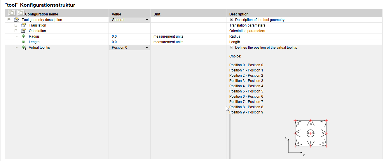

Example for MappMotion - Enable 9 Different Modes via altering usage of Tool Parameter “Virtual tool tip”
If the selction of 9 modes would be enought, you can use the Virtual Tool Tip which is normaly intended for a “Lathe” Application.
The Implementation of a Direct Transformation could then look like this. Where Mode 0 can be completly different to Mode 1. - Every time the Tool gets changed by the Programm, the System can handle the change of the Transformation.

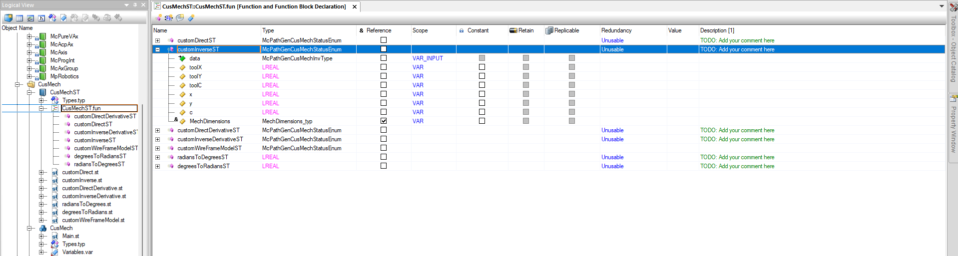

I forgot to mention the language and so on. The language is Structured text and MappMotion and such can be seen in the picture below.

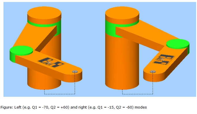

I think I explained it a bit wrong. Because I have 3 axes redundant robot, there can be multiple solutions for one given point in 3D space. The robot is declared and will stay the same all the time, same for the tool, these do not change. I have 5 mathematical solutions for the kinematics, that should lead on different positions of joints. I wanted to know, if it can be done/should be done in 1 library, where these functions are.
Would it be better/possible to put all possible solutions and change it internally inside the function, i.e. there will be new input for chosen solution and inside the function would be IF statment, where “IF solution1 = true THEN…. IF solution2 = true THEN….” Or if I should make separate custom mechanical libraries, where each library would have its own solution and I would be switching between these libraries, but the robot would still be the same
Thanks for providing the additional Information. Good that you use mappMotion and ST, so my example was already in the right direction, matching both.
I think we talked about the same thing , because Right_Handed or Left_Handed (Mode) is pretty much the same than Solution1, Solution2, Solution3 of a redundant System.
Same TCP-Position → Different Joint-Positions.
You can only change from one Mode to another if in this Position both Modes result in the same Positions. For the SCARA Q1=0 Q2=0 Long-Arm can be both right and left.
But typicaly you would use a Joint Interpolation G100 to move from one Mode to another, as TCP positions can be skiped in this Interpolation.

You told that you have always the same parameters for the tool, so you can use a part of Mechanical Data to descripe your tool-Geometrie, in this way, the tool-word would be completly free for usage of mode change. Would be a restriction for future use, but for the start a valid limitation.
If you have 5 Modes its lower than the possible 9 available.
So you can choose between Variant a) and b) in your Transformation Functions.
You can even use mcTOOL_VIRTUAL_TOOL_TIP_POS0 for Automatic , and mcTOOL_VIRTUAL_TOOL_TIP_POS1..5 for Manual selection of the Calculation Mode.

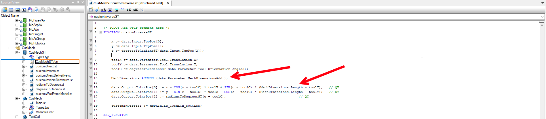

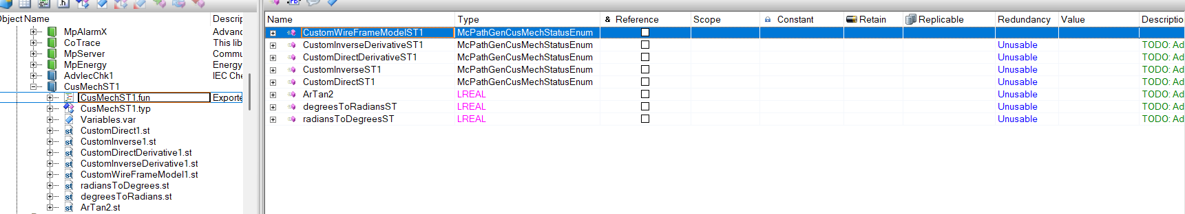

If you implement a Transformation Function here for example the Inverse, you must follow the prototype which is provided from B&R, so data is the only Input which should be used.
But you can add as much local Variables as you want.

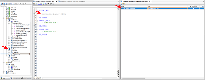

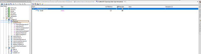

For Global Data there is the Mechanik Description. You can set up a coustom Datatype in the Library.
Then you can create a Instance of the Variable in an Task
Add the Variable to the Mechanic Description of the Coustom TRF Setting
The usage in the Transformation will look like this.
The Mechanical Data is shared by all Transformation Functions and is globlay available.
For the calculations in the Transformation Functions you should only use local Variables, as each instance is called multiple times.
