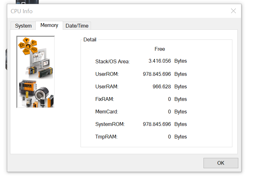

the error message is not caused by the CF size, but by to less available DRAM in your PLC.
Here’s a short description about the topic: when modules are transferred to the PLC, they first have to transferred and stored to DRAM, before they can be copied to CF. And if not enough DRAM is free, the module transfer fails - I assume, this is what happens on your system.
The PLC you’re using is a legacy one and quite old, it only has 32MB of DRAM and was developed many years before, when the versions of Automation Runtime, Servo Drive Operating System and so on where quite smaller then the lastest / last ones.

To get more DRAM, you need a more actual PLC. But there’s maybe one thing you could try → saving some DRAM by disabling Webserver + SDM.

    You can check the free DRAM of the PLC by using AS menu “Online → Info → Memory”, the free DRAM is the “Stack / OS Area” entry (my screenshots were made with a similar system).
I can’t swear that it works, but disabling SDM will maybe enabling you to get enough free memory for some tasks to program and transfer.
