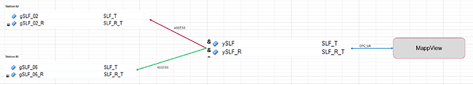

we often have duplicate stations in our projects, means two Task and one is referenced to the other.
Both have the same variable structure, see below “gSLF_02” and “gSLF_06” as an example. In an INIT file we assign the correct structure to the corresponding station.
My question is now, how can I handle that with my mappview visualisation? Because I dont want to have to build up all the content twice there…
I made a third globale variable with the same structure as the two station have. Now in dependence of the active Page (PageID is written in a variable), I ACCESS gSLF_02 or gSLF_06. This is done in the code, not in the visualisation.
All bindings in the mappview projects are done to the gSLF variable, so the values are switching correct, if I switch the page.
Now I have to problems:
  • HOw can I switch easily the text on the page (for example a name of an axis) in dependence of the active page?
  • If there would be a second client connected to the CPU, then his variables will switch to as soon as I change the ACCESS. So maybe he is on Page of SLF_02 and somebody switches on the other panel to Page SLF_06 - then his variables will also switch ACCESS to gSLF_06 even he is still on Page SLF_02 though
Or do you have any other ideas how to handle duplicated Stations/Task with mappView?
