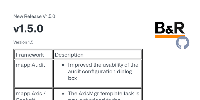

You’ll never guess what the mapp Framework team got you just in time for the Holidays…
A new release! Merry Christmas and Happy New ease of developing!
Version 1.5.0 is here!
Head over to our GitHub for complete details and revision history on the latest and greatest release.
As always user input and requests are much appreciated and encouraged!
