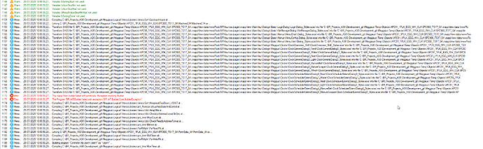

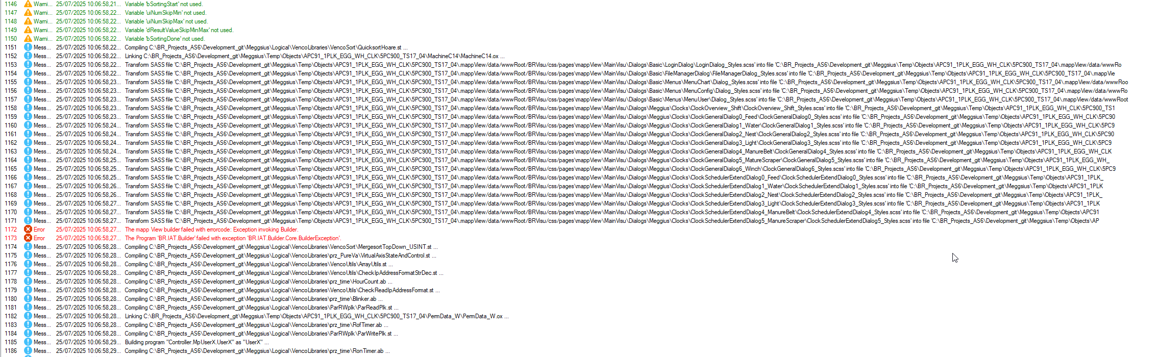

I have convert my 4.12 project to 6.3. I have multiple configurations in my project that referenced from only one basic configuration. Some configurations build in AS and some configurations give an error with the BR.IAT.Builder. (see below)
The basic configuration where everything is referenced from that build correctly but two configurations not.
Does anybody know what this could be?
Kind regards,
Tom
I have found the solution. My path name and name of the config together where too long.
