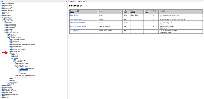

Recently we’ve tested de MC_BR_PowerMeter on an AcoposMulti Power Supply. This works great.
¿Is it possible to read in any way the regenerative power generated by an AcoposP3?

Hello and welcome to the Community,
AFAIK it’s not possible.
I am pretty sure there is no simple Functionblock Interface for this Data.
Please keep also in mind that the ACOPOS P3 is always a passive Device only able to consume Power from the Grid (B6 rectifier), it is not able to put regenerative energy to the grid.
The only possibility is to find a ParID which holds the Data and read it cyclically via Functionblock.
If we consider that we want to have the regenerative Power coming from the Motor to the DC-circuit.
This one looks quite prommising, as it is the Power at the Motor Terminal. But the documented ReadAccess looks quite unclear for me, as it states “not in Control” “not in Move” which would basicaly make no sense as these are the only scenarios the Motor would have Power. Looking at the formula given it should be able to get negative numbers. I currently have no system to test up… if you have one give it a try.
