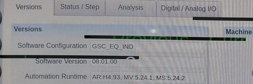

PPC2200 screen showing another background page on current operating page
observing screen sever or other pages in background in current operative page in ppc2200.how to resolve it or what is the reason behind it.
Hi Kalpesh,
This looks like a screenshot of a web browser running in Windows or Linux. My guess is that it’s a graphical glitch in that operating system. Does it persist after you restart the PC?

no it is intermittent… it was comes some time only.
its running on operating system Linux 10
I think this is tricky to diagnose since it’s happening within the GPOS and is so intermittent. This thread is re-opened in case anyone else has any ideas, but you may need to reach out to your local B&R support contact to see if they have any advice.
