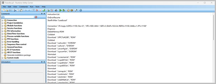

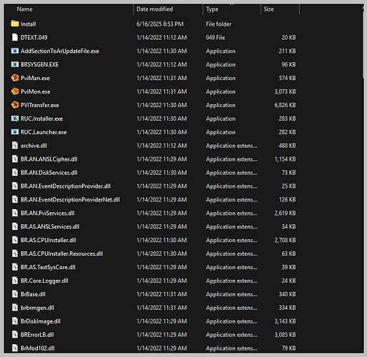

I received Project Installation package to program Power Panel C70 , as below and I have some question:

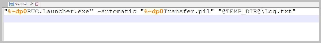

1 - The installation is starting when I click on start.bat file which contains the below code, so what is the function of file RUC.Launcher.exe ??
Is this mean lunch this PIL file instructions?? if yes , so what is the function of the program RUC.Launcher.exe ??

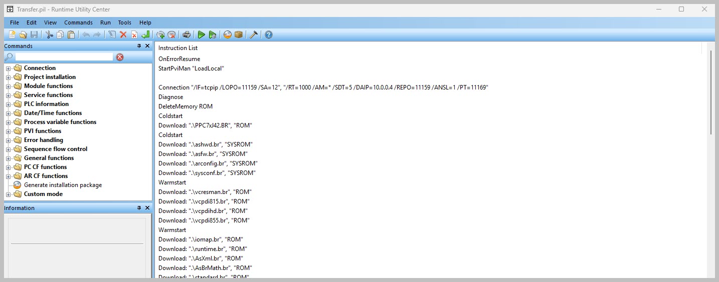

The Runtime Utility Center (Ruc - PviTransfer) can be used to download a project to the PLC without AS.
The folder is created with command Create installation package in RUC.
