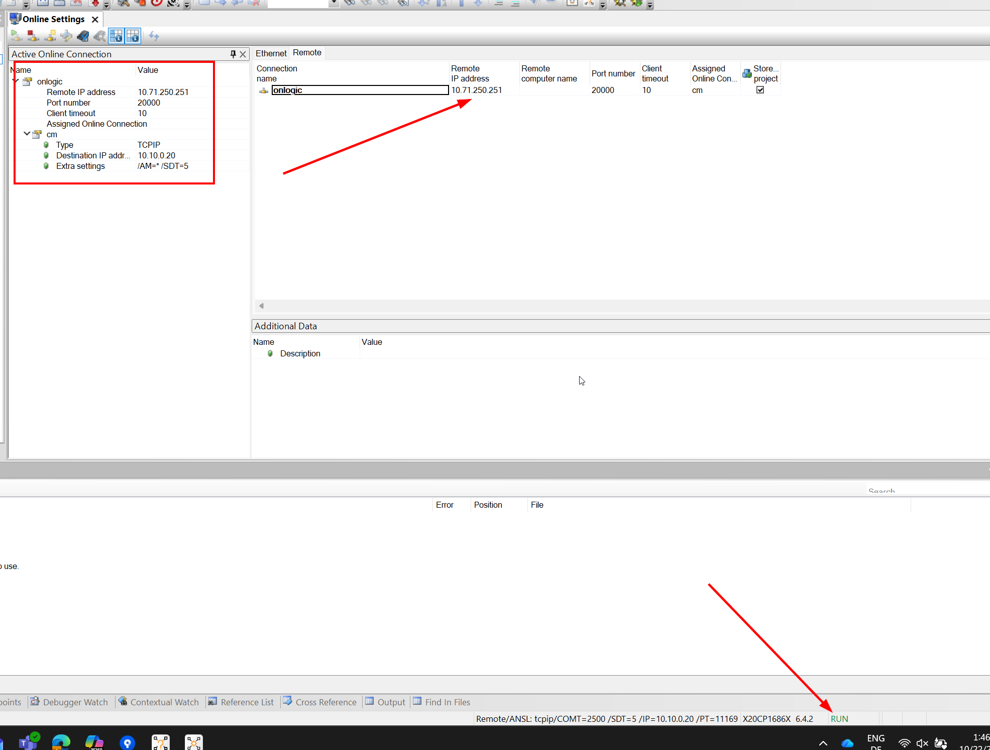

Hi Communitiy,
im using a AS remote connection to connect to a X20CP1686X through a Win10 PC. Im in Run in AS, but cant watch any Variables in SAFEDesigner. Is there any way to establisch such a connection? Using AS6.3.4.31(localy) and PVI6.0.2.50 (Win10-PC).
KR and Thanks!
as I understood you’re using a Windows pc as remote endpoint, from where the online protocols have to be forwarded to the plc and the safe logic? And you’re able to access the plc via AutomationStudio, but not the safe logic via safe designer? Am I right?
If yes, can you please give us more details about how the remote connection looks like?
Of which type is the remote connection, is a vpn tunnel with routing pr port forwarding on the remote side, or is it pvi remote?
Correct! The Win10-PC is my remote endpoint running PVI on it. AS connection to the PLC is already working. Safedesigner to SPLC is not. No VPN tunnel/port forwarding is setup on the remote endpoint.
Here is the connection:
BR Kenan

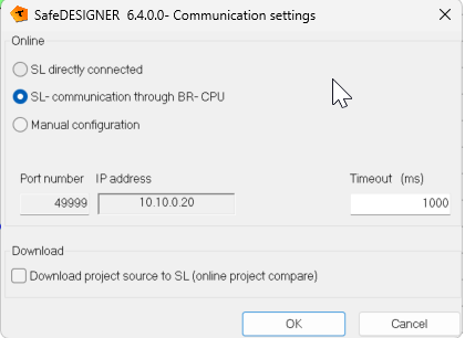

For some internal reason i had to put the SafeDesigner<>SPLC communication port on 49999. (Variable watch and legacy controller dialog operation possible)
See SafeLogic config in the HW-Tree:
