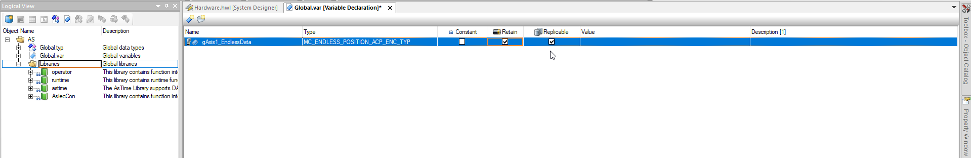

So first you have to Define a Retain Variable of correct Data Type.
After the BootUp of the PLC you have to execute the Functionblock with a Reference to the ACOPOS Axis (Encoder) and the Reference to the Retain Data. It should give a Done and DataVaild. You can remove the Execute afterwards.

The Data is still not initialised, you now have to make a Homing of the enocder to tell the system to initialise the Data in the Retain memory.

The Motion System knows now the Retain memory and it is initialised. It starts cyclicaly to monitor your encoder in the background.
After a PowerOff and PowerOn cycle of the PLC you can now use the HomingMode
mcHOME_RESTORE_POS to restore the Position from the Retain Memory.
