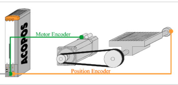

I have an application using a servo motor, and I’m experiencing a position drift issue. The servo motor drifts approximately 2 mm after 3–4 hours of continuous running.
Hardware:
  • Servo Drive: ACOPOS P3: 8EI8X8HWD10.xxxx-1
  • Servo Motor: 8LSA44.DB030S000-3
AS Settings:
  • Rotary-to-linear transformation: 207.65 mm
  • Gearbox ratio: 8:1
  • Measurement resolution: 0.01 mm
Motion Details:
  • Axis moves forward and backwards continuously.
  • Velocity: 700 mm/s
  • Acceleration: 700 mm/s
  • Deceleration: 500 mm/s
  • Load: 40kg
Observations:
  • Drift accumulates over time (~2 mm after 3–4 hours).
Does anyone have any idea what could be causing this drifting issue? Please let me know if more information is required.
Thank you in advance!
Alvin

Hello Matt,
Yes the mechanism is using belt.
Servo motor - gearbox - coupling - belt.
I have a question on this “You can try calculation via gearbox info/belt info, how much backlash/elasticity is in your transformation from motor to load to see if this 2 mm of accuracy falls within the accuracy of the system.” Can you please explain this in more detail on how I can do this or provide a simple example on this?
After discussion with my team, we are considering a 2-encoder control setup, where an additional position encoder is mounted at the belt/load side to compensate for these errors. Something like this:
Are there alternative solutions/workarounds you would recommend?
Thanks in advance for any insights!
Alvin
the reading of position didn’t change at all but the real position was changed by few mm.
This sounds like it could be a mechanical issue to me
Could a pulley be slipping on the shaft?
Can you mark the shaft ends and pulleys to see if a pulley is slipping? Maybe a scribe line across the shaft end onto the pulley
I assume toothed belt, so is it jumping teeth?
Move to a reference position, mark both pulleys with vertical lines using a square, take a photo and check again later at the reference position

Hi Alvin,
Accumulation of position error is typical in vertical-axis applications (even with rigid couplings) when no integral action is present in the controller, resulting in a non-zero steady-state error. I can imagine the same occurring for horizontal-axis applications as well. If that’s the case, simply add some integral action and test it..
