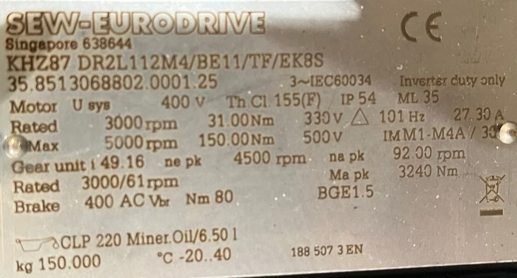

we use SEW DR2L asynchronous servomotor with ACOPOS 8BVI inverter. This geared motor is not typical induction motor.
this motor only allows delta connection.

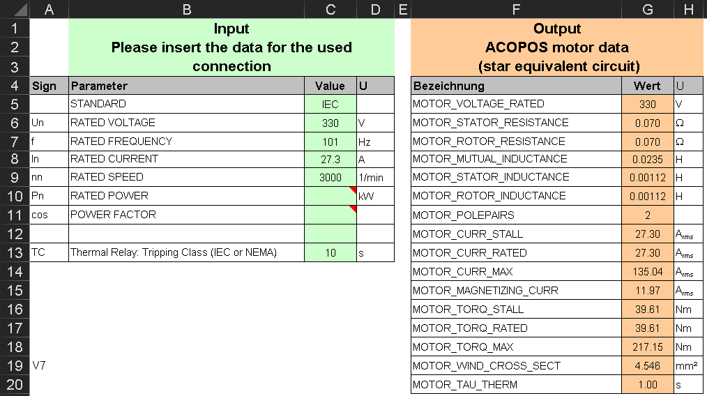

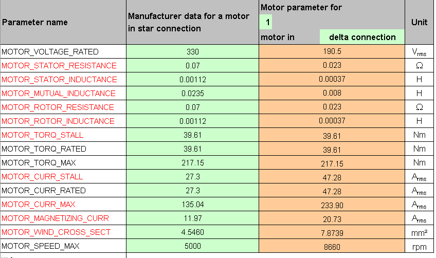

from the help I got two excel file to do calculation. but I don’t really understand how to use it for this special nameplate.
I am very confused on how to input parameters to AS. If anyone can help me?
if the below input is correct? and which column result I should use?
asyncconnection.xlsx (16.9 KB)
asynctypeplate.xlsx (17.2 KB)
