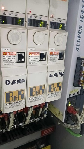

Software, Cable, and Communication Protocol for Uploading Parameters from Acopos Inverter P74 to PC
I want to upload parameters from an Acopos inverter P74 to a PC. What is the name of the software and the communication cable used between the Acopos inverter P74 and the PC? What is the name of the communication protocol between the device and the PC?
Anwenderhandbuch P74
See Chapter 5.7 Accessories for the Communication Cable ACPinverter ↔ PC
The Protocol used is Modbus.
I think this should be the Tool, but it requires a Login for Download. If you do not have a login for the B&R Website, contact a local B&R sales representive and request one.
ACPinverter Parameter Tool
In case you have Tools and Cables for Schneider Electric Inverters, they will be compatible.
