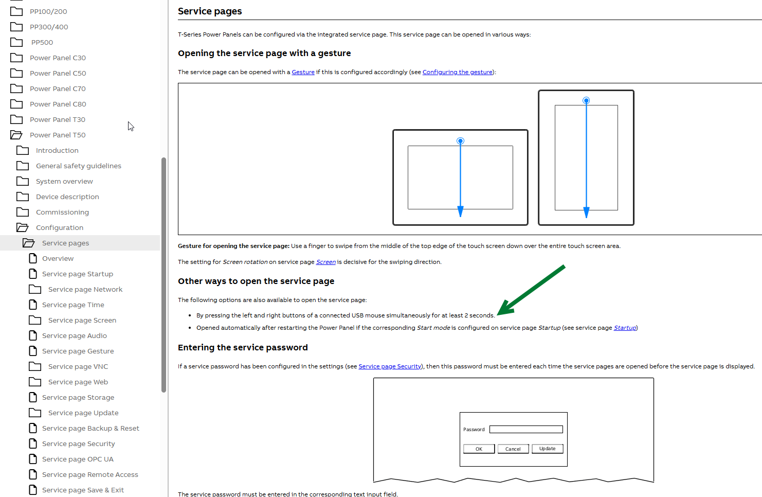

If you try to enter service pages (with the gesture or by pressing the left and right buttons simultaneously for at least 2 seconds), is it possible? Or are you asked for a password?
Thanks for having me and thank you for your time.
Unfortunately the service page doesn’t work, not with the gesture or pushing the 2 mouse buttons simultaneosly.

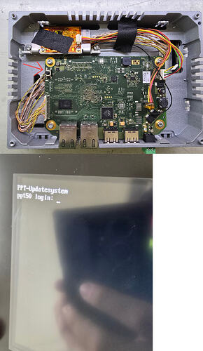

which button do you press while turning the panel on? Can you share a photo of the screen with “PPT-Updatesystem, ppt50 login:”?
Hello and thanks again for replying.
This is the back button I’m pressing while turning ON the panel and the text/command line that appears.
I tried to use a USB keyboard on this screen, but no input is detected.
Best regards
I have no idea what the purpose of the button is. I believe it’s not officially documented since it’s not accessible on a chassis.
Every update procedure documented in the help requires accessibility of the Service pages. That’s why I don’t see any other option apart from contacting a local B&R office and sending the T50 for a repair.
