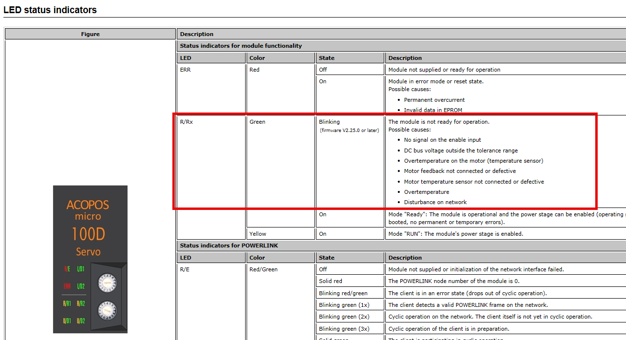

80VD100PD.C000-01 R/R1 & R/R2 Blinking
R/R1, R/R2 blinking
enable is there
but what is the issue ?
Enable is not the only thing that can cause this, see the help:
If you can already find the axis in the network, by using either ACP10 and the test window or mappMotion and mappCockpit, both could tell you what’s the issue by trying to turn on the controller - or writing anything to the ParID CMD_ERR_STATE_INTO_FIFO (340)
