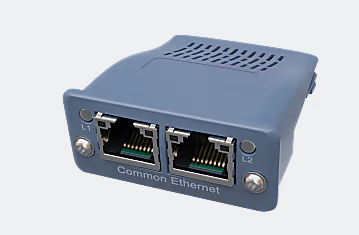

we are currently using a CPU X20CP3687X with connected a slave with installed an AnyBus CompactCom 40 module and we are experencing a problem when the master (CPU) is restarted.
It seems the slave does not reconnect again anymore to the master and it necessary to restart also the board.
Has anyone found and solve this problem?
With other firmwares, Ethercat and Profinet, we are not experiencing the same problem, so I think it’s specific behavior of Powerlink protocol
Many thanks
