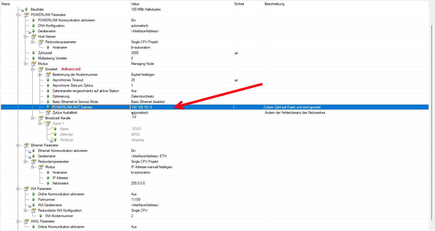

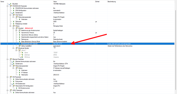

i think you have the Default Settings active, but can you post the Powerlink Configuration part of Advanced. So we have a possibility to check this values. Thanks.
As @valerio.manenti mentionned above:
In the powerlink configuration, please let the “Ethernet parameters”, “INA parameters” and “ANSL parameters” to default values.
You didn’t need to specify the IP Address and Subnet Mask for Powerlink.
For INA parameters it’s a legacy protocol that is here for compatibility, so you let default value because you not gonna use it.
For ANSL it’s the current protocol to communicate from AS to the PLC, but on the Powerlink it didn’t needs to be activate, it’s already activated on the ETH (IF2).
Hope that could help!
Florent

@valerio.manenti
You must first change the SubnetMask in order to prevent that he thinks you use this huge subnet.
I have currently no time to try… but i think then the error you show does not occure.
It is for sure possible to have IP-Activated simultanious to Powerlink, i even made ANSL Routings and online Communication in the Past. But this Projects were on old Laptop.
If he has this requirement to use it we can make it work, but you are all right, if there is no need we shall start simple.

thican’t fin
ican’t find power link ip NAT
yup German is not easy, better the English version:
Ciao
Valerio
not exist alsoi tried but not found
