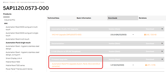

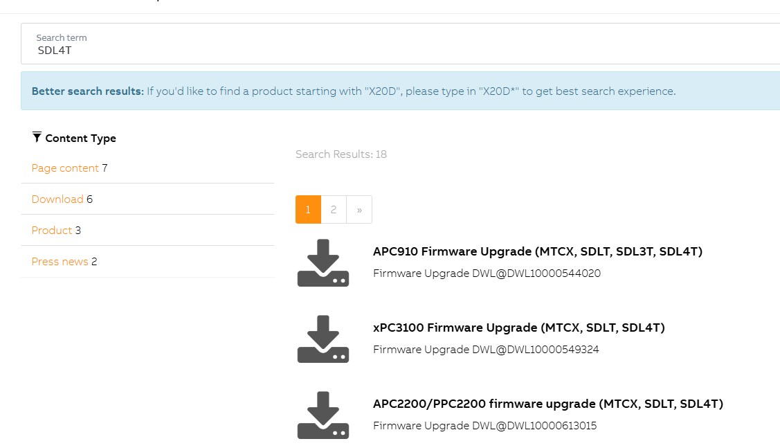

I would check download section for your type of APC as well as for panel.
just example how to search:
SDL4 transmitter
SDL4 receiver for AP1120
if fw is up to date, cable is original..and there is no problem with connection and any other visible problem, you will need to get in contact with local B&R support.
