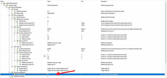

Hello Dominik,
these are my settings with which the stepper motors work in the simulation:
Regards

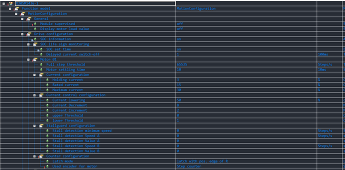

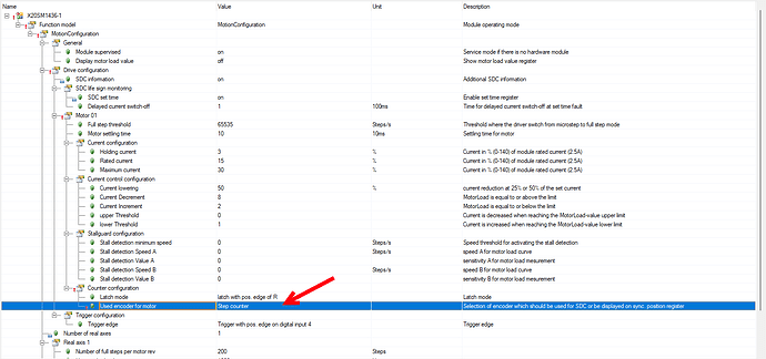

thanks for your reply. The steppers work just fine. I just want to understand, why there is a velocity proportional lag error with the modul X20SM1436-1 and not with 80SD100XD.C0XX-01. There has to be some kind of model in the background that calculates the lag error. But for my application the lag error is not relevant. So i want to deactivate this.
Here are my configurations:

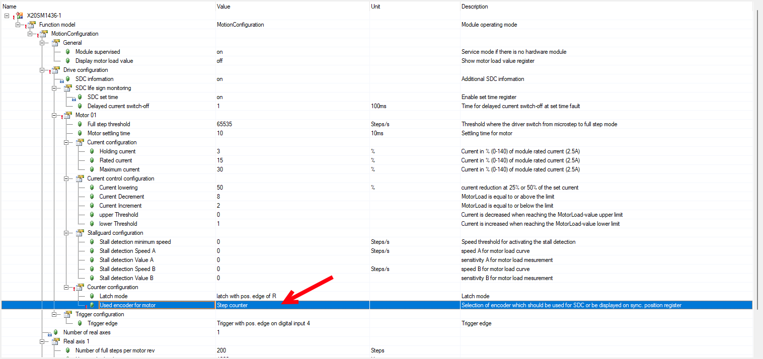

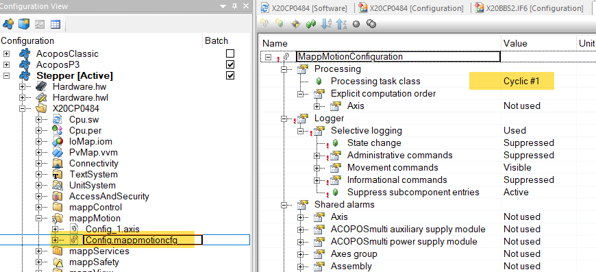

Out of curiosity, am I missing something? My configuration tab for the X20SM1436-1 looks quite different while selecting “MotionConfiguration”, and I also can disable the Encoder.
Even when adding a new module the config stays the same for me.
Version 2.3.3.0
grafik
Which AS version, module version and Co are you using?
Hi Julian,
it looks like you are using mappMotion, is that correct? I am still using “ACP10 ARNC Motion”. Maybe that is the reason the configs differ? My AS Version is 4.12 and the module version is 2.3.1.0.
Indeed you are correct, I am using mappMotion. Thank you for clarifying.
Unfortunately I can not assist you any further, but I believe with the versions listed someone else might be able.

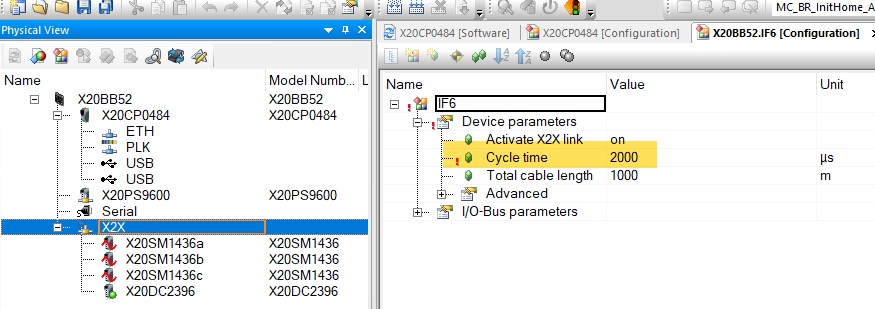

I think the root cause is the T-Total and T-Predict Setting of the Axis, which is set up to
compensate the Field-Bus Timing.
If you set the Values to 0.002 which is in my case the TC#1 Cycle Time the behaviour changes to following Error almost 0.
I could currently not find a diffent behaviour due to setting a encoder or disabling the encoder Interface.
If there is no encoder i think you do not have to consider bus timings on a real hardware,
so setting T-Total, T-Predict to TC#1 timing should be a possibility.
Does my findings on ACP10 SDC match your situation?

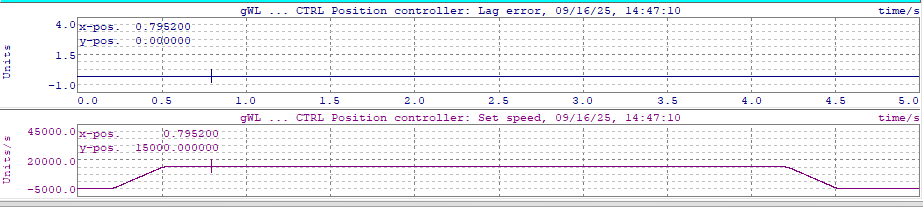

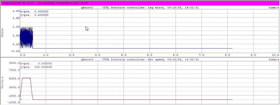

Hi Michael,
thanks for your reply. I also tested on a real system. Same behaviour. I checked every parameter i am aware of including the mentioned T_predict and T_Total. All are the same. But still the axes behave differently…
Trace 80SD100XD.C0XX-01 ( lag error always 0 , spot on)
Trace X20SM1436-1 (I can reduce lag error via t_predict but never 0)
There must be some kind of mathematical model which simulates the lag error. But I dont know how to switch it off/on.

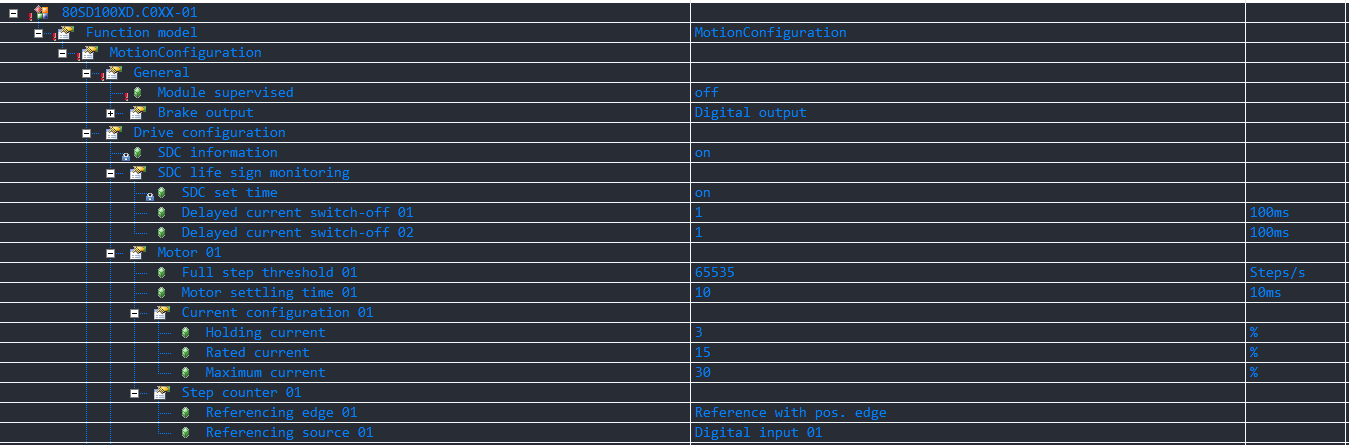

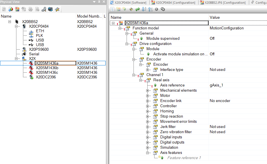

    HW Configuration:
    X20SM1436-1
    80SD100XD.C0XX-01
Best regards
Dominik
The Module X20SM1436-1 is configured as “has encoder” and gets the “Step Counter” from the X20SM-Module with an resolution 51200 Units/rev. via the Encoder-Cyclic Datapoint.
Which makes the Axis Encoder less. But the Act-Position has still a Bus-Timing because the Set-Points move to the module and the result moves back to the SDC. So to have a small LagError you need a T-Total which compensates this, and i think you will never reach a flat 0 , as there will always be some variation ± .
If the Module 80SD100XD.C0XX-01 has Sensorless mode “off” and still configured a gAxis1_HW.EncIf1_Typ := ncSDC_ENC16; It is unclear how the feedback is simulated.

In MappMotion i have seen a different Timing of the Modules with -1 in comparison to them without when using an Encoder. So there is defnitly a difference in the Firmware and Timing. But this does not explain all your findings.
