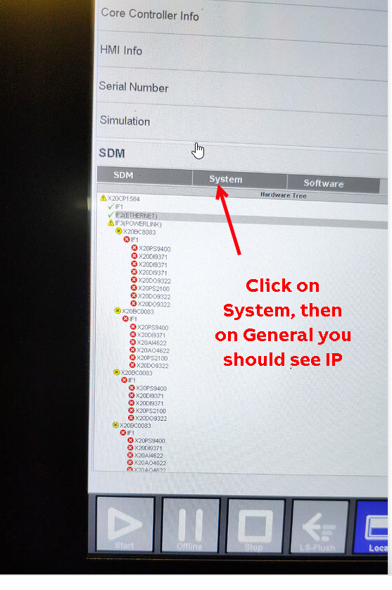

Hi we have br cards digital input / outputs and the R on each of them are blinking green. The hmi on the panel we have these faults. Can someone help me pls

Thanks Valerio that you are helping me from were i get the ip address from the hmi i think right? And with the system dump what i will know pls. Sorry i am asking questions but i am new on these things
Hello Joseph,
If you can see the System Diagnostics Manager, then the IP address will be listed within the System page, General tab. It looks like the picture you uploaded is of the HTML pages (loaded in the HMI), so you may have to scroll down depending on the viewer size. Look for a section labeled Ethernet Network Devices as shown below (3).
(1 System page, 2 General tab, 3 Ethernet Network Devices section, look for IF2 as that’s the Ethernet port on the X20CP1584)
-Austin
Hi Joseph,
on your HMI click on SDM > System
then General

My engineer is downloading the automation studio 6 software to try to connect with the machine. With the software you can see the faults also valerio ?
Obtaining the SDM system dump file by connecting with your laptop and downloading it will provide us with enough information to determine what the PLC is seeing and provide some next steps.
Some observations from the picture you provided that may help you find and resolve the issues:
  • Check on the System Page > General Tab, that the Current CPU mode is RUN. If this is SERV or otherwise, then there is a critical fault on the PLC. The hardware is expected to be not communicating because the PLC is in fault. The SDM System Dump will provide information about the status of the PLC.
  • Check that the POWERLINK cable is correctly plugged into the IF3 port (looks like an Ethernet port, labelled 13 below) and that cable is connected to the X20BC0083 modules.
    Operating and connection elements
  • Ensure that the POWERLINK cables are in good repair (not frayed/spliced/damaged/etc).
  • Check that the node numbers on the front of X20BC0083 modules match the machine documentation, and that there are no duplicate node numbers.
You can also review the SDM Hardware icons to give you some idea of what the PLC is seeing and reporting via the SDM. Link: Using the Hardware page
