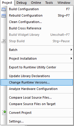

Which Automation Runtime version you’re using, and could you please try to change this version? To check and change, please open “project → change runtime version”
To get a different / new Automation Runtime version, you can check via “Tools → Upgrades” for “Automation Runtime” and select the version you want to use, please also download “ArSim” for use with simulation.

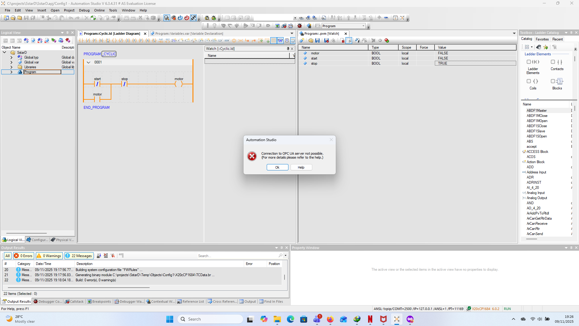

Thanks guy, installing the latest patch 6.3.4 solved, one more thing, for the graphical representation of the logic during simulation having below errors.

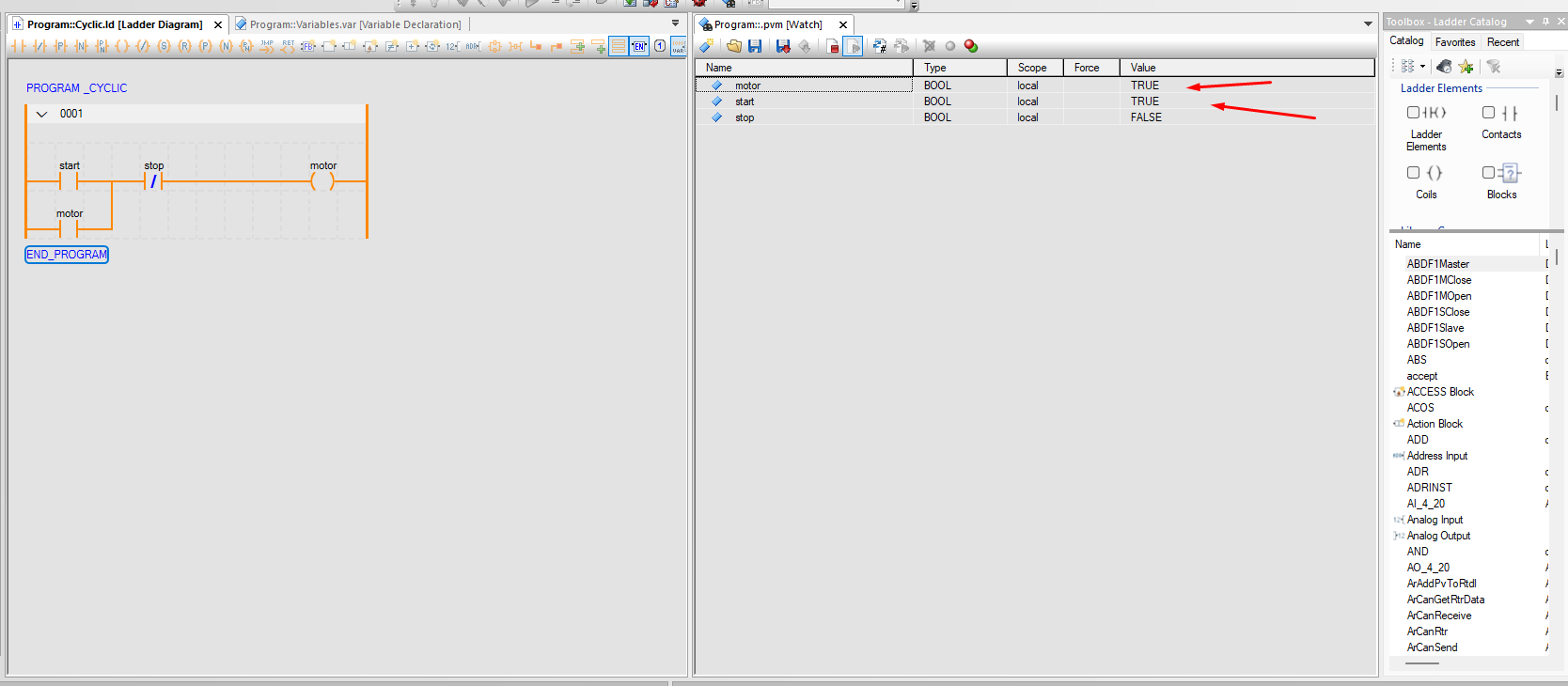

hence the graphical representation was there when the change states as seen below.
not a fan of ladder though testing thing out to be sure. Cheers.
Not sure where the help link leads but my guess would be that you need to enable the OpcUa system in the configuration.
This help section explains the steps OpcUa server configuration or check out this page explaining the required setup for Ladder monitor mode

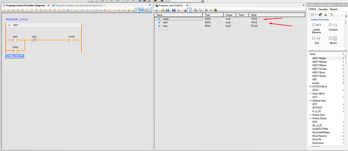

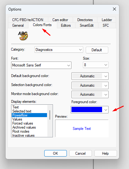

I see, i was able to enable the opc, however unable to login, which is fine because the server is not setup just yet and not need for now, however, for the powerflow, I have not been able to have them change when the rung is activated. although, I have followed the share link I confirm that the color is already set.
why this shows that the code is working when i turn false to true in watch table.
